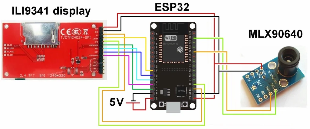

urgent help DIY Infrared Thermal Imaging Camera with MLX90640 and ESP32.
hello,
I’ve been working on making a DIY Infrared Thermal Imaging Camera with MLX90640 and ESP32.
I have attached the wiring diagram I used.
the code i used i got it from this
site https://www.instructables.com/Infrared-Thermal-Imaging-Camera-With-MLX90640-and-/
I did everything right, but it’s still showing me an error: it says ‘serial’ was not declared in this scope. Let me know if you can help me out.
I appreciate any help you can provide.

No, there is an error in the code: “serial” is not declared
Post the code, using code tags.
hello
no the code does not work its says :
In function 'int MLX90640_I2CRead(uint8_t, unsigned int, unsigned int, uint16_t*)
Compilation error: ‘Wire’ was not declared in this scope
‘Serial’ was not declared in this scope
48 | Serial.println(“No ack read”);
POST ALL THE CODE, using code tags (“<>” editor button).
i added the wiring diagram,but i couldnt upload files so i provided the link
copy/paste the code into your post, using code tags.
i did that,i downloaded the code, and i think i dowloaded the right libraries,but its not working and its driving me crazy
You need to post the code that you are actually trying to compile, directly into your post, using code tags.
The link is useless, because you may have altered the code or incorrectly copy/pasted it.

Please edit your post to add the code tags. Select the text and use the “<>” code button to format it properly.
Also post the complete error message, using code tags.
Failure to pay careful attention to instructions can be a serious problem in advanced, technical hobbies like this one.
Why is this “urgent”?
hello
alright,i will try and edit the code.
Im new to this and this is my first time using the platform so im unfamiliar with how this should be.
Compilation error: 'MLX90640_DumpEE' was not declared in this scope
My guess is that you copied that code from somewhere, but installed one or more wrong device libraries. In particular the code mixes Sparkfun and Adafruit libraries for the MLX90640, which is a bad idea.
Start over from the beginning. Find a good “getting started” tutorial (Sparkfun or Adafruit, for example) and follow the directions step by step, very carefully.
do you happen to know where i can find the right librabries?
Yes.
Carefully follow the instructions in the getting started tutorial you have selected.
The ones from our guide will work for the examples in our guide (note that the guide uses a Teensy Microcontroller, you won’t need the mentioned Teensyduino library, you’ll use esp32)
I suggest downloading the library and loading example1 from the mlx examples menu (with esp32 as your board selected)
