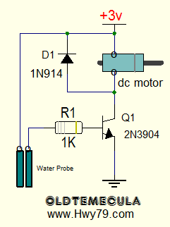

Was hoping I could get some help building a simple water switch to power a small motor using a AAA battery as a power source.
I’ve bought an arduino test board along with a resistor kit (1ohm-1Mohms) and a kit of various transistors. I’m trying to wire up a simple switch with 2 probes that power the motor when in contact with water.
I’ve researched the very basics of reading schematics and tried a few designs I could find on the internet but none have worked out so far. It seems like this should be fairly simple to wire up but I’m fairly lost figuring out which transistors and resistors will be needed for a AAA power source (if that will even work).
Here are some of the switch designs I’ve tested so far with slight variations:

  • http://www.oldtemecula.com/sparkfun/water-switch.gif
    I drew the basic circuit because I could not find it on the web. You will lose .6 volts across the transistor is why I say use 3 volts but go ahead and try a single cell. Water needs minerals in it (salt) to conduct so distilled water will not work.
    The motor needs to draw less than 100 ma.
    Any additions or corrections are welcomed.
    Christopher

    Looks great. I know I have the transistor and resistor, let me check and see if I have diode. Once I have that I'll test with both one and two AAA batteries.
    Edit: Looks like the arduino kit came with 1N4148 diodes which according to Google should function the same as the one you have in your design.
    oldtemecula:
    This worked perfectly!
    Thanks a ton man, you rock.
    Here’s a picture of the setup with the motor spinning:
    http://imgur.com/b3ZjJo2
    Anyway to tweak it so it’s more sensitive and needs less salt in the water?
    Amenconi said: Anyway to tweak it so it’s more sensitive and needs less salt in the water?
    [http://www.oldtemecula.com/sparkfun/water-switch2.gif](upload://kORE9O1QMipnsXS5XR4oix8xLXl.gif)
    The original circuit has a sensitivity or gain of 100. Adding the extra transistor known as the Darlington combo will push the sensitivity to well over 10,000. (100 x 100) Now you need to use 3 volts as about 1.5 volts are lost to the circuit and battery decay.

    This is great. I'm gonna do some testing with the original design and see if it's sensitive enough but very nice to have a back-up plan.
    For some reason though the latest design image link is broken. Though I don’t suppose chaining the same transistor twice will be that complicated.
    Thanks for all the help. I’ll update thread if my project goes anywhere and actually yields something demonstrable.
    I finally received my 3V batteries and tested the version of the circuit with the darlington chain for increased sensitivity and it worked great. Before I had to dump a bunch of salt for the emerged probes to complete the circuit but the new design it worked right away with regular tap water.
