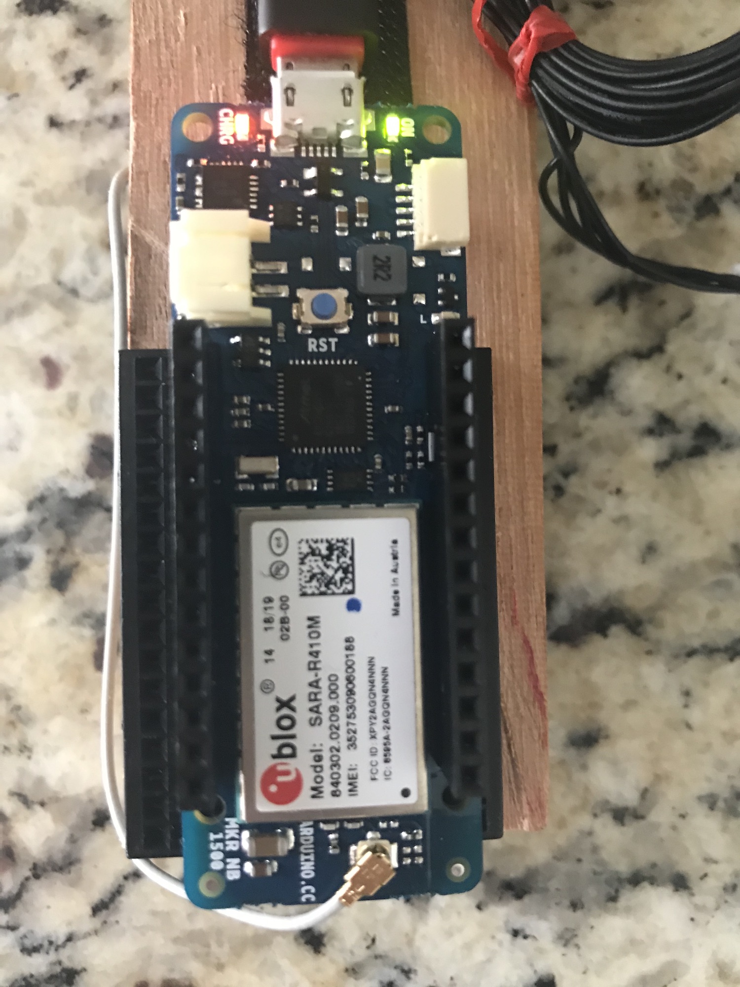

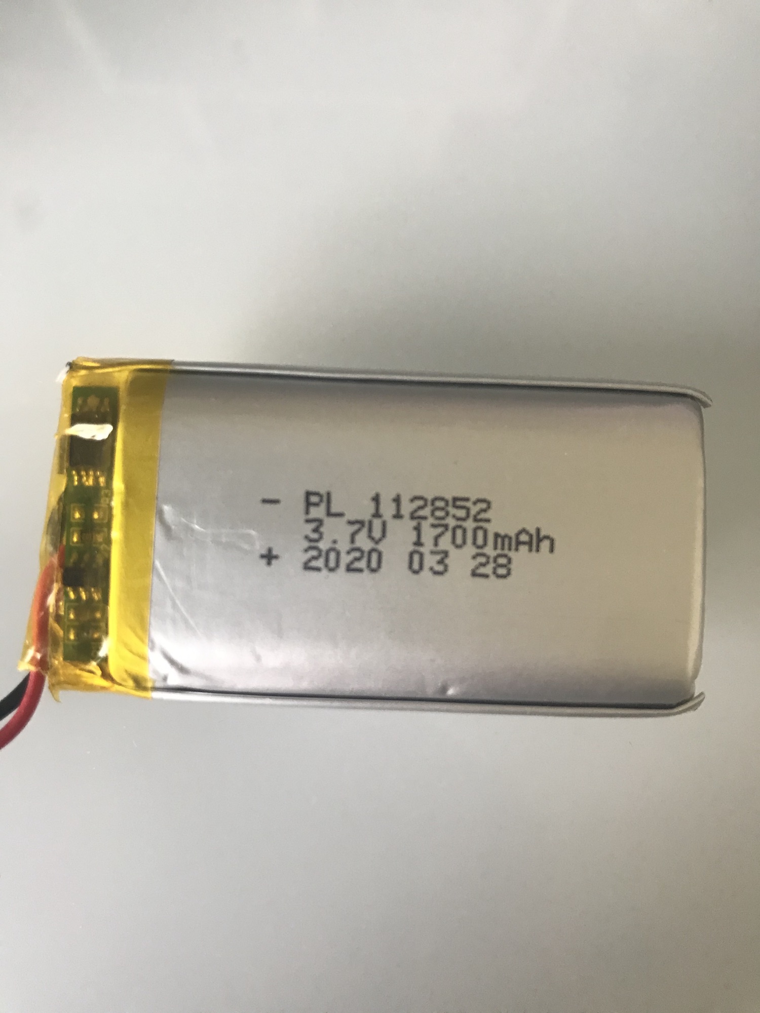

Hey All,
I am having issues with my current battery on my Arduino board. It is a 3.7V, 1700 mAh. I had to swap the + and - within the connect to match the polarity of the Arduino. However, I plug it in and the board says it is charging, but I can’t ever get the board to work off the battery. Is there another battery I should be using or am I just doing something wrong? Thanks in advance.
Are you able to host pictures of your setup somewhere else (like Google Drive) and share links to them?
Yeah.
Battery → https://www.philipdbrown.com/philipdbro … attery.jpg
Board → https://www.philipdbrown.com/philipdbro … _board.jpg
Thanks.
If you’ve confirmed that the battery is operating correctly, then I would suggest requesting an RMA for the board and viewing our returns policy: https://sparkfun.com/returns
