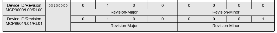

Hi Cameron (@cameroncoding79 ),
From the datasheet, the MCP9601 returns 0x41 and so will fail the library Device ID check:
Apart from that, the two devices are very similar. The MCP9601 has short / open detection, whereas the MCP9600 has “Input Range” (thermocouple over-range) detection. But, that’s the only difference I can see in the datasheet.
To resolve this, we would need to:
  • Update the MCP9600 library so it will accept the ID of the MCP9601
  • Update the library to support open-circuit and short-circuit detection on the MCP9601
  • Rebuild the OLA firmware using the updated MCP9600 library
