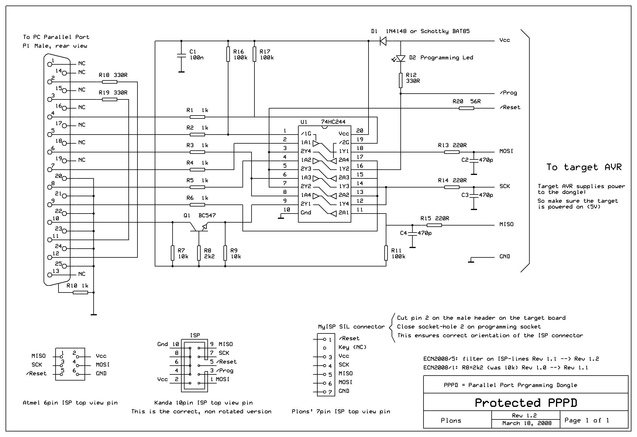

This is the schematic I used for the programmer:
http://www.aplomb.nl/TechStuff/PPPD/MyFinalPPPD.png

I checked the programmer circuit many times, and I verified that the circuit is powered and the MISO, MOSI, SCK etc are correctly connected to the target AVR. The parallel port is also working and if I connect an LED to MISO, it drops low briefly before glowing dimly again. I also tried a different ATMEGA8 in case the first one was broken.
avrdude and Ponyprog report that the “device is not responding” and that I should check the connections.

This jumps out at me. When I did the same test, I found:
RESET (pin 1 on CPU): Normally high, but goes briefly low when programming.
SCK (pin 19 on CPU): Normally low, but goes briefly high when programming.
MISO (pin 18 on CPU): Always low, even when programming.
MOSI (pin 17 on CPU): Normally low, but goes briefly high when programming.
I’m not sure why MISO would glow dimly when the chip is not being programmed. I tried this again on my breadboard, and MISO is normally low, but glows dimly when programming (I believe it is echoing what comes in on MOSI).

This sounds like a problem with the programmer. The operation of the programmer should go something like this (see 27.8.2 in the datasheet):
  1. RESET is normally high, but is pulled low and held low to put the CPU in programming mode.
  2. SCK is a serial clock generated by the programmer, in time with programming bits sent on MOSI. When programming, you should see a regular train of pulses on SCK, and data on MOSI.
  3. The CPU will echo back on MISO.
It sounds to me like you’re not seeing signals on either SCK or MOSI, which make me think the program isn’t even making it as far as the CPU.

Wow, I’m not sure I’ll be much help debugging the programmer. I definitely can’t do anything without seeing the other side, but even then I’m not sure I can make sense of the incoming wires.
However, what you’ve said about MISO, MOSI, and SCK definitely seems to indicate something before the target board–either in the programmer or in the software end of things. You could perhaps narrow it down by taking a look at the signals coming into the programmer. What do you see there?
