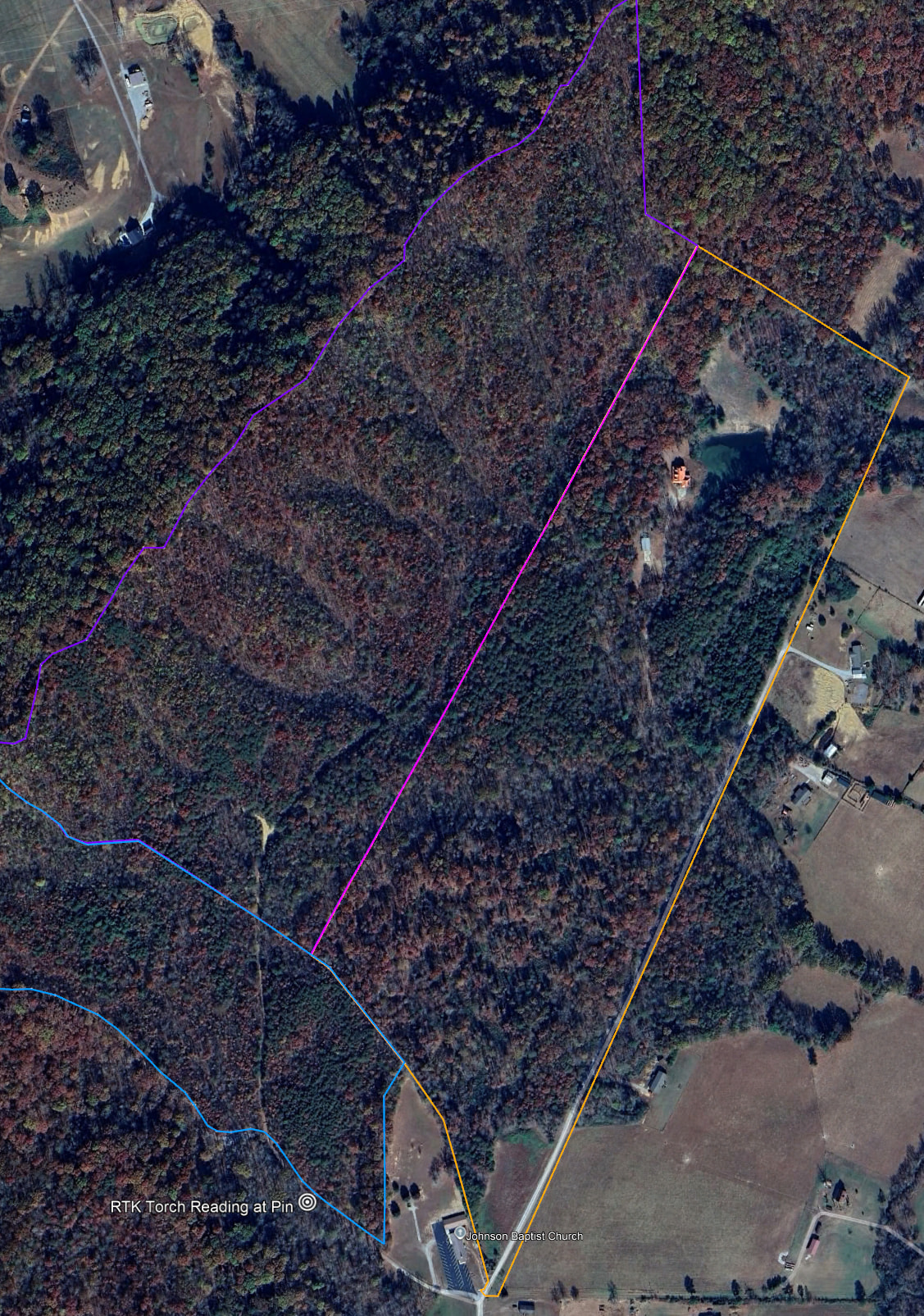

    • Created KML overlays for my 63-acre property and the neighbor’s 62-acre property (both very irregular shapes) using the various corrections options, Ground Distance, RTK Localization, RTK Scale, etc
  2. Aligned the KMLs on the shared capped pins and other monuments → they matched within 1–2 inches at those points.
  3. At the far (uncapped) end of the 2,677.76 ft line, the KML overlays showed a 2-3ft discrepancy.
Here’s what overlapping boundary lines can look like when viewed in Google Earth:
At the north border below, no monument other than fence line
  1. Fortunately, this was along a fence line mentioned in both deeds → strong physical evidence we were in roughly the right place (±3 ft was acceptable).
    • We weren’t building a permanent fence — just a firebreak/dirt trail — so minor differences along the length were fine.
  2. I loaded both color-coded KMLs into SW Maps on my Android Tablet.
    • Walked the entire line from the uncapped end.
    • Dropped pink flags every 50–100 ft (spacing depended on visibility through the woods)
  3. My neighbor walked the flagged line afterward and agreed: “Good enough” for our non-permanent purpose.
