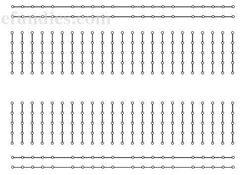

I’m not sure that this is the right place to post this question, but I am working on a project and I’m trying to test a TI tps regulator. To test the regulator, I breadboarded the Webench design and wired everything correctly but the regulator gave no output voltage. Do any of you have suggestions? Is it possible that a Webench design would not work with through hole, breadboarded components?

Switchers require very careful layout and short leads. They won’t work on a whiteblock.
A few things jump out at me:
  • Where’s the inductor?
  • Whiteblock connections are vertical in the position shown in the picture (except for the power busses). You don’t have anything connected in the compensation network or feedback divider. This http://efundies.com/guides/fundamentals … pinout.jpg
shows how the connections are set up.
