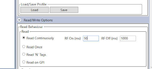

//Begin scanning for tags
//There are many many options and features to the nano, this sets options
//for continuous read of GEN2 type tags
void RFID::startReading()
disableReadFilter(); //Don’t filter for a specific tag, read all tags
//This blob was found by using the ‘Transport Logs’ option from the Universal Reader Assistant
//And connecting the Nano eval kit from Thing Magic to the URA
//A lot of it has been deciphered but it’s easier and faster just to pass a blob than to
//assemble every option and sub-opcode.
uint8_t configBlob = {0x00, 0x00, 0x01, 0x22, 0x00, 0x00, 0x05, 0x07, 0x22, 0x10, 0x00, 0x1B, 0x03, 0xE8, 0x01, 0xFF};
//Timeout should be zero for true continuous reading
SETU16(newMsg, i, 0);
SETU8(newMsg, i, (uint8_t)0x1); // TM Option 1, for continuous reading
SETU8(newMsg, i, (uint8_t)TMR_SR_OPCODE_READ_TAG_ID_MULTIPLE); // sub command opcode
SETU16(newMsg, i, (uint16_t)0x0000); // search flags, only 0x0001 is supported
SETU8(newMsg, i, (uint8_t)TMR_TAG_PROTOCOL_GEN2); // protocol ID
sendMessage(TMR_SR_OPCODE_MULTI_PROTOCOL_TAG_OP, configBlob, sizeof(configBlob));
with this API if I want to set RF on time with 50ms and RF off time with 1000ms how can I set?
