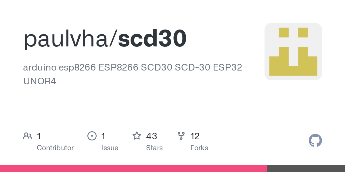

Thanks, with link you mean this one?
So I should look into SoftWire() ?
The overall setup will not use Wifi, so I do not necessarily need ESP23.
