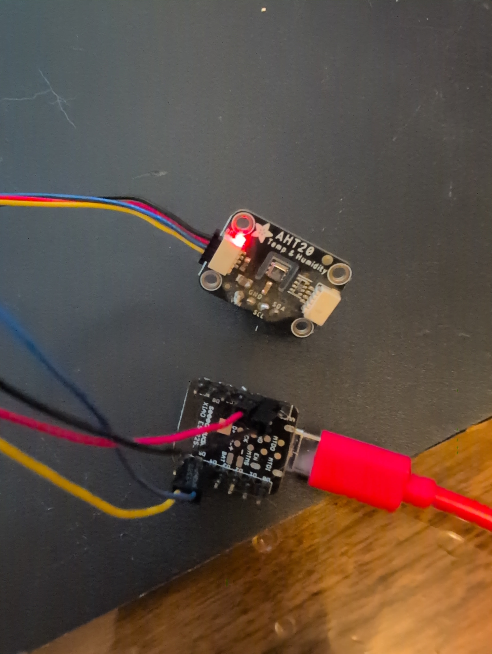

However, I just tried the sensor with a Seed XIAO ESP32S3, yellow to the 3.3v pin, blue to gnd pin, and matched the tx/rx to both (referencing the hookup guide), and i still receive no LED on bootup. Just the SEND command in serial monitor. Trying to avoid a 5v board and logic controller but i can still test that if need be (thanks for the IO pin info on the nano every, didnt realize that). Appreciate the help.
Is there any way to test with a multimeter to see if its getting power? I don’t yet have a USB breakout to test the connection with those pads on the back of the sensor.

I’d maybe try testing some other sensor using the same cable if possible and see if we can isolate the issue to either the scanner or MCU
Got lucky! Have this AHT20 sensor, that just so happens to be STEMMA QT compatible with Qwiic i just read. Used the same exact cable as before and I see an LED on the sensor. Flashed a test sketch from the library and i am getting readouts.

Alrighty, I think it’s a defective sensor then - Was it purchased from us? If so head over to Return Policy - SparkFun Electronics (contact vendor if purchased elsewhere) and we’ll get ya squared away
It was, and will do. Thanks for the help. Cheers.
