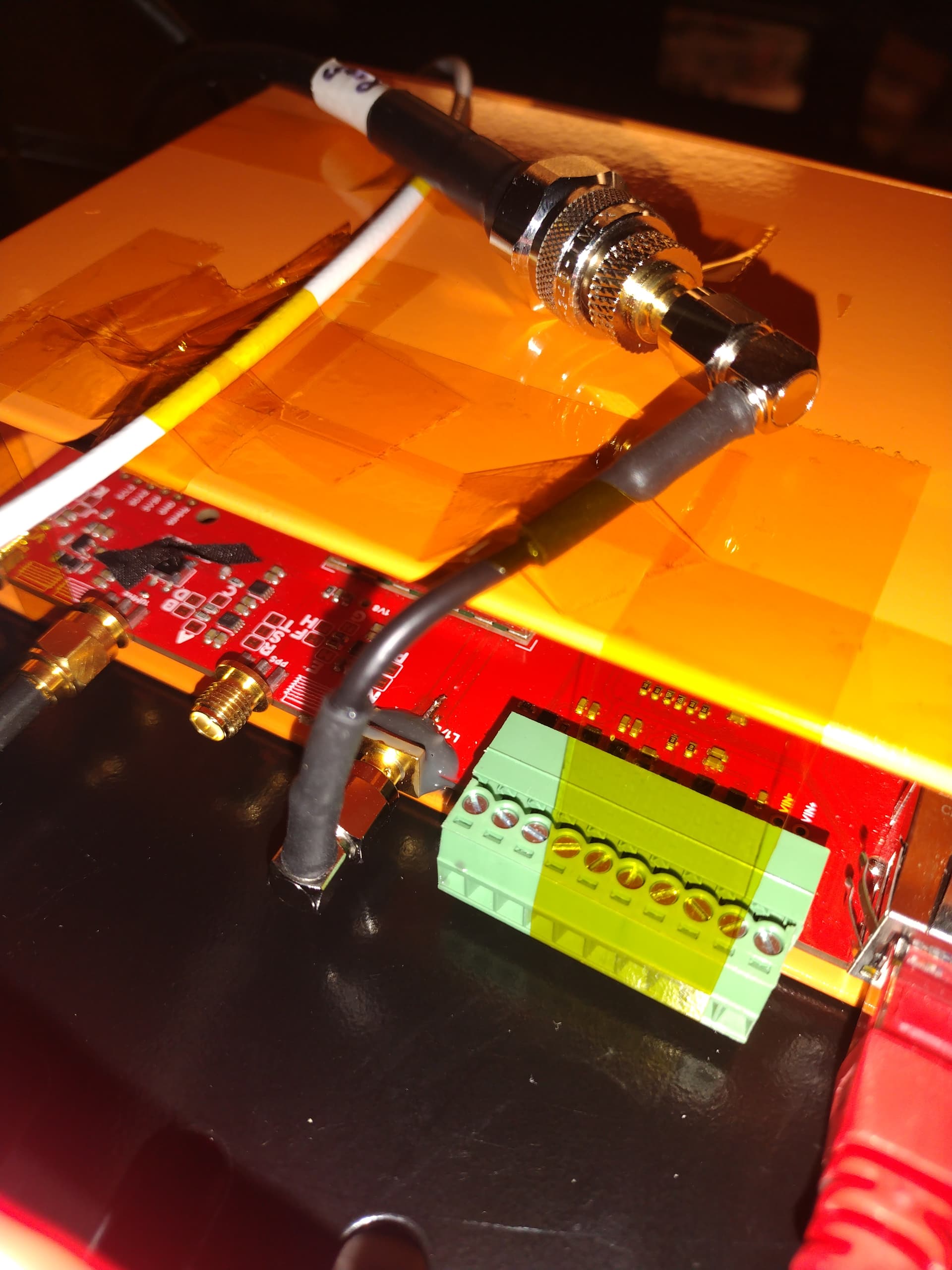

Do you mind taking a photo of the antenna fix? Sometimes flux residue or similar in the area can cause problems
Here is a photo of the fixed antenna connector. I can try to take a better photo if that would help. We added epoxy to keep the connector in place.
Hi @akortyna ,
Thank you for the photo. That is helpful.
Can you please tell us how the antenna connector was broken? Did you drop the unit while the antenna cable was attached?
Can you please tell us what values you see for “Bias” on the OLED display? Are the values sub 1 nanosecond most of the time?

The antenna connector broke off when the sma connector was being screwed on. The unit has never been dropped.

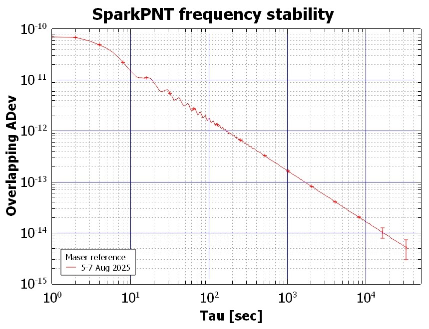

Dear Paul,
The attached Allan deviation plot verifies that the 10MHz oscillator is disciplined to the GNSS signal. Thank you for the help!
Andy
