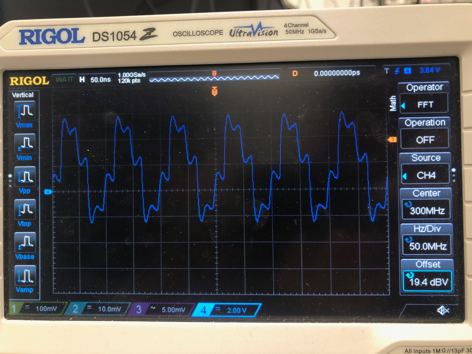

I recently got a GNSS receiver along with the antenna from SparkFun, the SparkPNT GNSS Disciplined Oscillator, and the 10 MHz output on the box seems to be 20 MHz and not 10 MHz. The output sine wave also appears distorted when looking at the signal on the oscilloscope, with multiple harmonics. I am local and I’d be happy to drop off the equipment if you’d like to take a look at it.

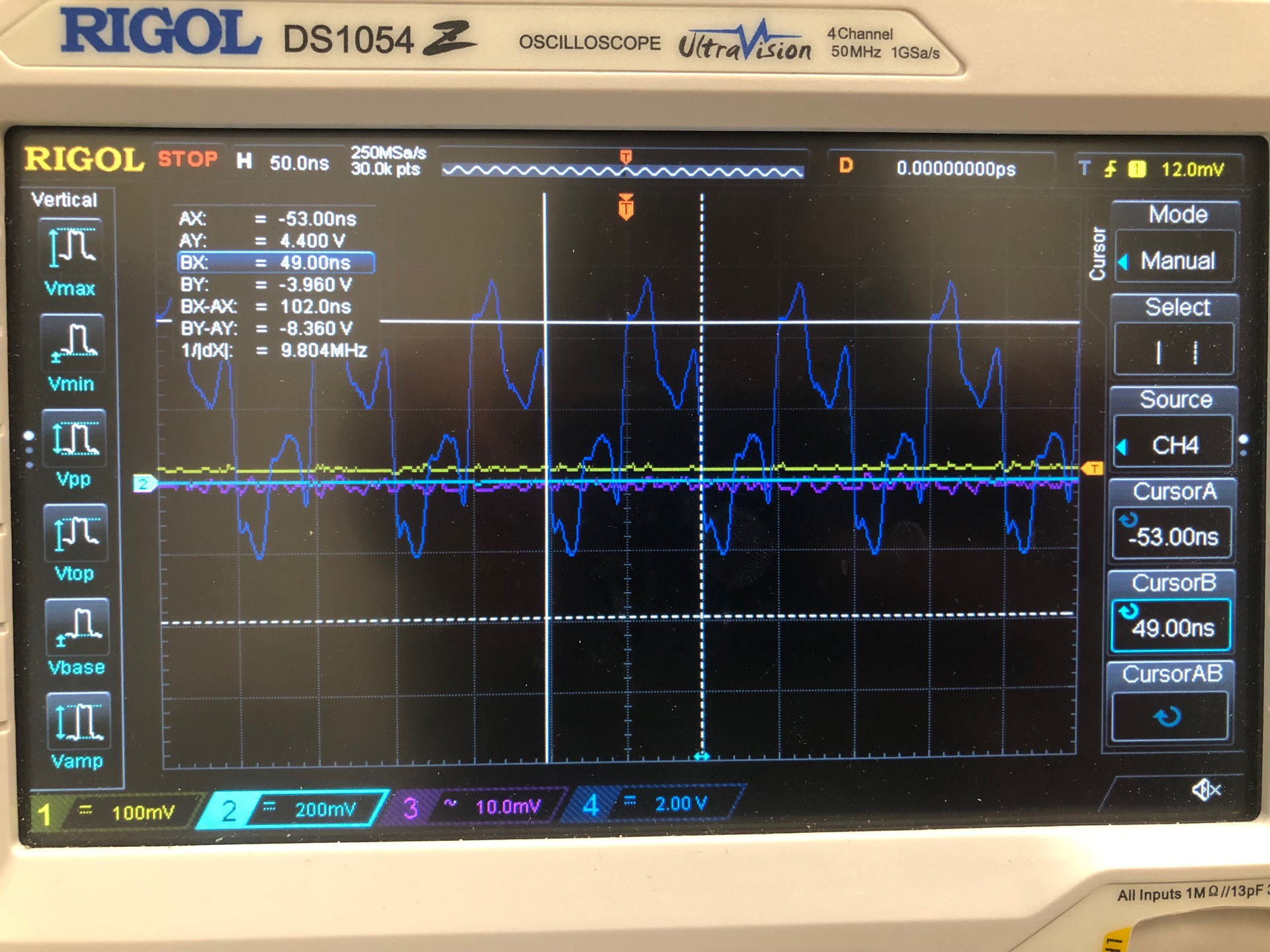

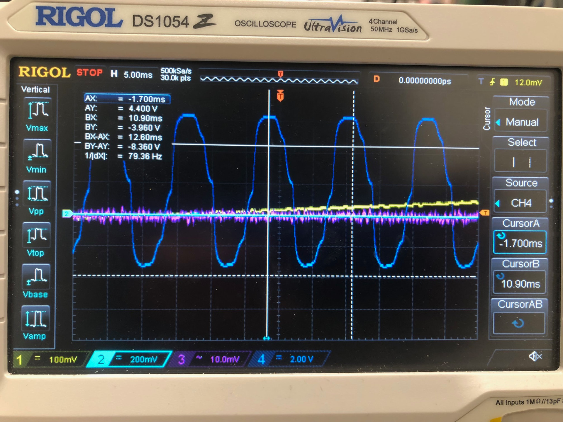

This is the signal I see on the scope. This is with 1 MOhm termination. The signal also looks the same with a 50 Ohm termination attenuator.
Thank you @gabriela ,
Very strange. That looks like the sum of a 10MHz square wave with a higher frequency sine wave.
How is the GNSSDO connected to the ‘scope? Are you using the provided SMA-BNC cable?
Is anything else connected? Perhaps a signal generator?!
Please check you have GND connected.
I see FFT at the Top Right of your screenshot. Is that relevant?
Hi Paul,
I have tried different SMA cables and have seen the same result. The signal is connected directly from SMA to an SMA/BNC adaptor. There is a ‘GND’ on the green pinout rail but I am not using that at all. The receiver is powered via USB connection to the computer. The FFT on the scope was just to measure the frequency components of the signal, which showed different harmonics at 10, 20, 30 MHz, etc.

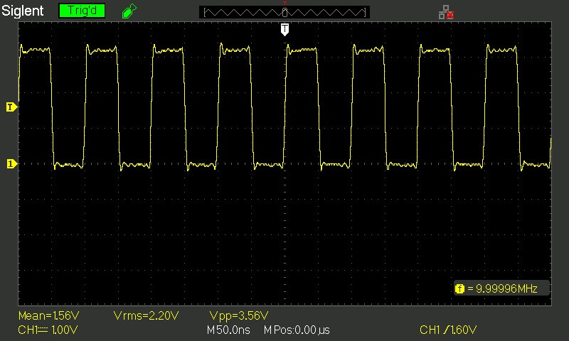

The signal should look like this:
The small amount of overshoot / ringing is due to it not being loaded perfectly.
I have my GNSSDO VCCIO switch set to 3.3V. My 'scope is set to 1MOhm input impedance and DC-coupling.

I’ve powered the system so that it is directly powered from the wall outlet with the included USB-C cable and I am still measuring 20 MHz on the frequency counter. Below is the signal on the scope. It looks slightly less distorted but still not what you are showing.
I’m thinking we may need to send this unit back to you. My company is local so I can drop it off anytime. Let me know how you’d like me to to move forward.

It looks like you have your 'scope timebase set to 5ms per division? Can you please try again with it set to 50ns per division - like in your first screenshot.

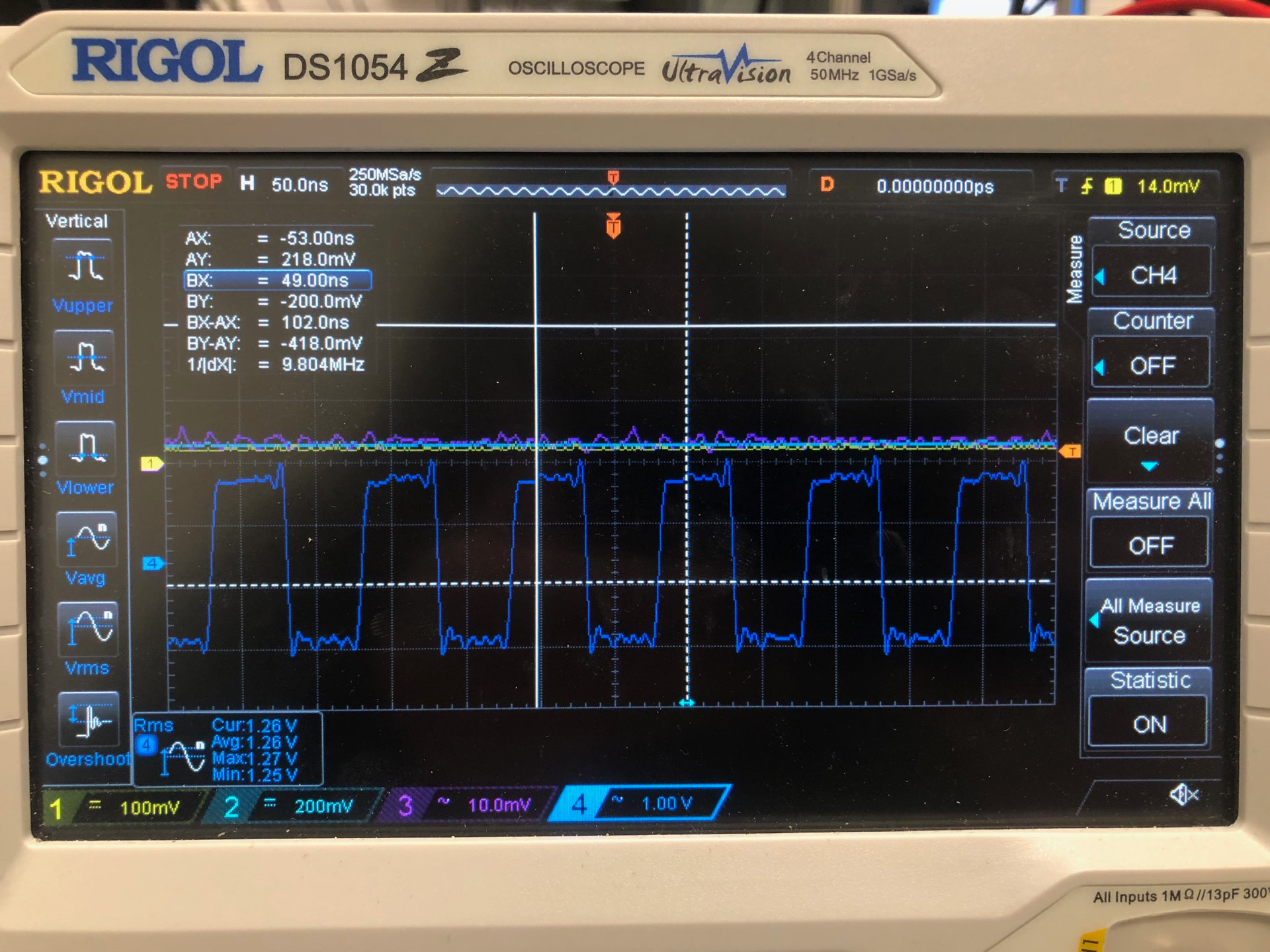

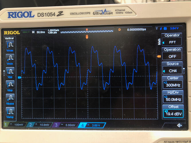

The frequency counter is connected separately so each time I take a measurement the signal is connected directly to either the scope or frequency counter. The frequency counter I’m using is from the SRS FS740 frequency reference, which also has a frequency counter function. I’ve double checked all of my connections and I’m still measuring 20 MHz output and a distorted signal. Below is an image from the scope with the 50 ns time division scale. It does appear that the feature has a frequency of 10 MHz, but not the square wave that you’ve shown. I’ve taken out an extra BNC adaptor so the signal looks slightly different from the images I sent earlier today.

I am concerned that you somehow have an output from the SRS FS740 Frequency Reference connected to the 10MHz output from the GNSSDO.

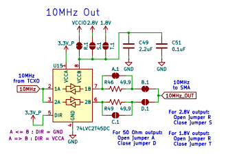

To my eyes, the waveform on your oscilloscope looks like the sum (addition) of a 10MHz Square Wave with a higher frequency sine wave. To me, it looks like the sum of the 10MHz square wave output from the GNSSDO, with a higher frequency from the SRS FS740.
The waveform on your oscilloscope is approximately 8.0 Volts peak to peak (4 divisions at 2.00V per division). The GNSSDO can not produce 8.0Vpp.
The GNSSDO 10MHz output is produced by a 74LVC2T45 transceiver. The 74LVC2T45 is powered by “VCCIO”. VCCIO is either 3.3V or 5.0V, depending on the position of the VCCIO slide switch. The default setting is 3.3V.
It is impossible for the 74LVC2T45 to produce signals higher than 5.0Vpp.
If I’m honest, I believe you have misunderstood your connections from the GNSSDO to the 'scope and the SRS FS740. I believe you have connected the GNSSDO 10MHz to an output from the SRS, and your 'scope is displaying the sum of the two waveforms.

I’ve connected the 10 MHz output directly to the scope with the SMA cable provided and I’m seeing that same signal I sent previously. The SRS FS740 has nothing to do with the oscilloscope measurements. I am only using the input on that just as a frequency counter. The antenna cable is a very thick, good quality cable and the antenna is currently on the rooftop so we cannot change that connection.
I have found that I can add a tee to the end of the BNC cable with a 50 Ohm termination on the other end and the signal looks similar to what you have shared (maybe a slightly smaller signal). So I guess this is an impedance matching issue.

Hi Gaby (@gabriela ),
I am sorry. I owe you a big apology…
I had forgotten that, on my GNSSDO, jumpers A and E are open. By default, they are closed:

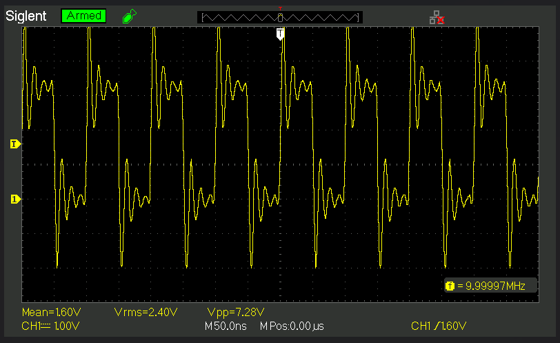

If I close jumper A, I see:
If you are feeding a digital load, you will want jumper A to be closed. If you are only feeding high impedance inputs, like your 'scope, then opening jumper A avoids the overshoot and ringing.
