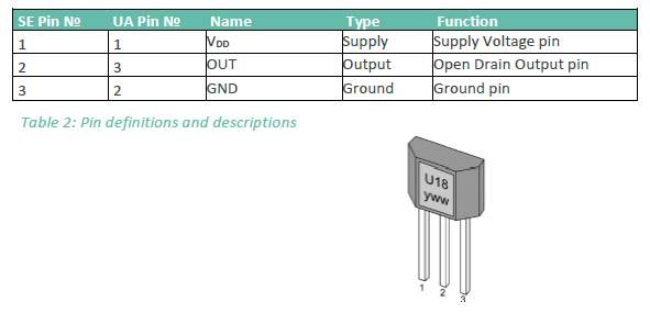

Thank you for the information. That helps a lot. I contacted Lamp & Pencil in the UK and they provided a datasheet very promptly. The circuit below should work well with both types of candle.
To keep this really simple, I’m going to recommend trying a good old PNP Transistor. The 2N4403 should work well, it can handle up to 600mA and 40V. Sadly, we don’t stock it or any equivalent transistors, but you’ll be able to pick one up from Amazon.
You also need a 220 Ohm resistor. There’s one in our resistor kit:
US1881 Pinout:
2N4403 Pinout:
