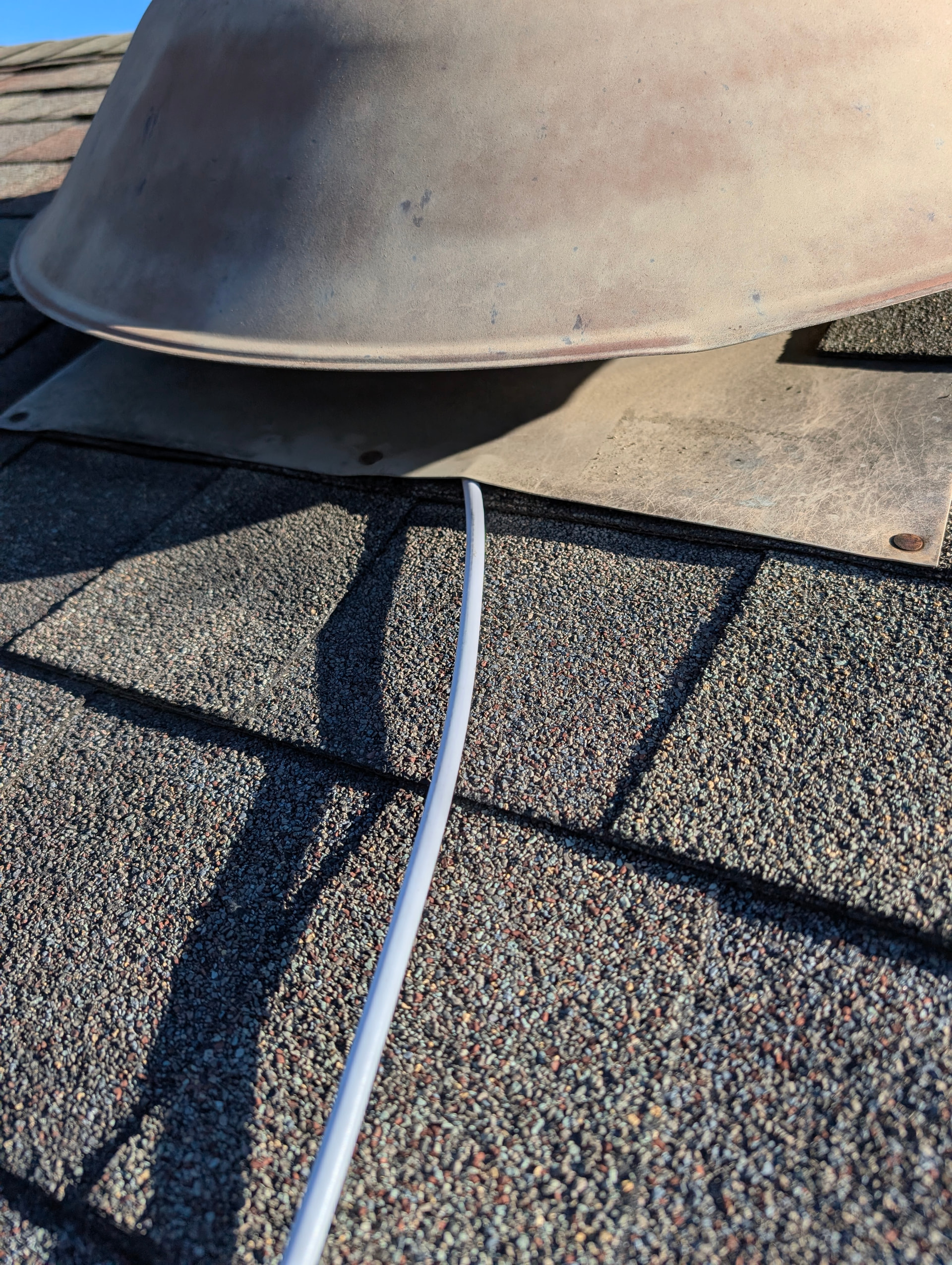

I ran the coax under the flashing of a powered roof vent fan. You can probably do the same with plumbing vent flashing as well.
