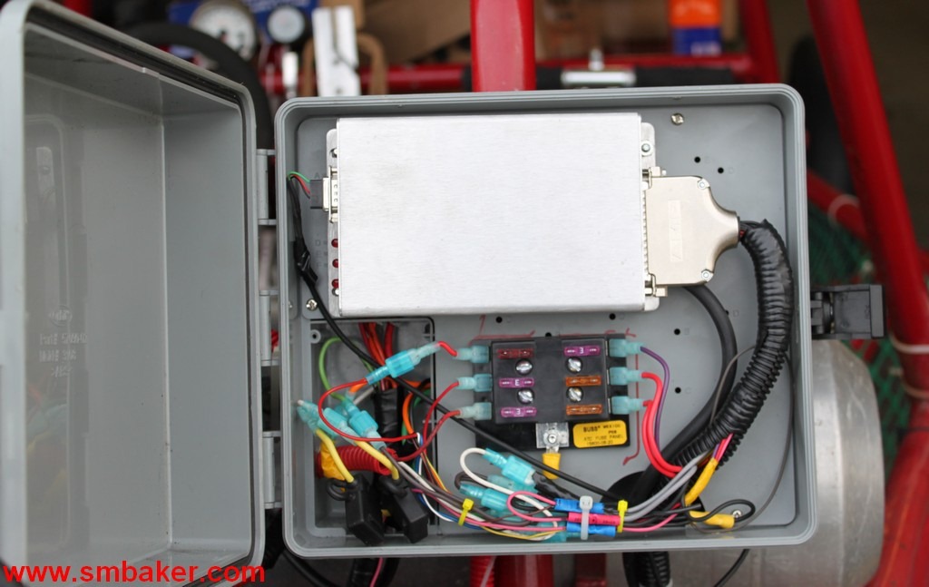

Back when I needed something like this I found a sprinkler timer box (rain-bird, I think) at the local hardware store. The good thing about this was that it was a removable panel inside with a grid of holes drilled in it (there’s more space behind the removable panel where you can hide even more components). The whole thing is water-tight with a gasket. I don’t think it’s quite 12x12, but it’s not far off.
Here’s a picture – It’s housing a fuel injection computer on my sandrail.
http://www.smbaker.com/wordpress/wp-con … il_ecu.jpg
EDIT: Actually it looks like it was an “orbit” sprinkler timer box, part #126702 from Lowes.
