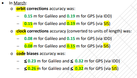

I’ll share my current “theory” here for discussion in case I’m missing something regarding HAS E6.
When we look at the HAS Performance Reporting, the latest results (March 2025) are as follows:
These are improving over time, when you look back at older reports :wink:
Let’s consider the GPS constellation only for now.
After our GNSS device applies the HAS/E6 corrections, the 3 error sources listed are still 19cm (orbit), 15cm(clock), and 32cm(code) - each independently contributing to the final position error. And we have no atmospheric correction yet.
