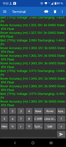

Hello, I’m reporting my initial experiences.
The firmware loaded without any problems.
It seems to be an old version, as I can’t find several improvements, such as accuracy information, fix time, and more.
Regarding the Galileo HAS corrections, with the small helical antenna, but with a clear sky, I only got floating, with a differential age between 5 and 15 seconds. The base station ID was 9002.
I was on it for a long time and it didn’t go beyond floating.

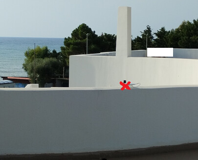

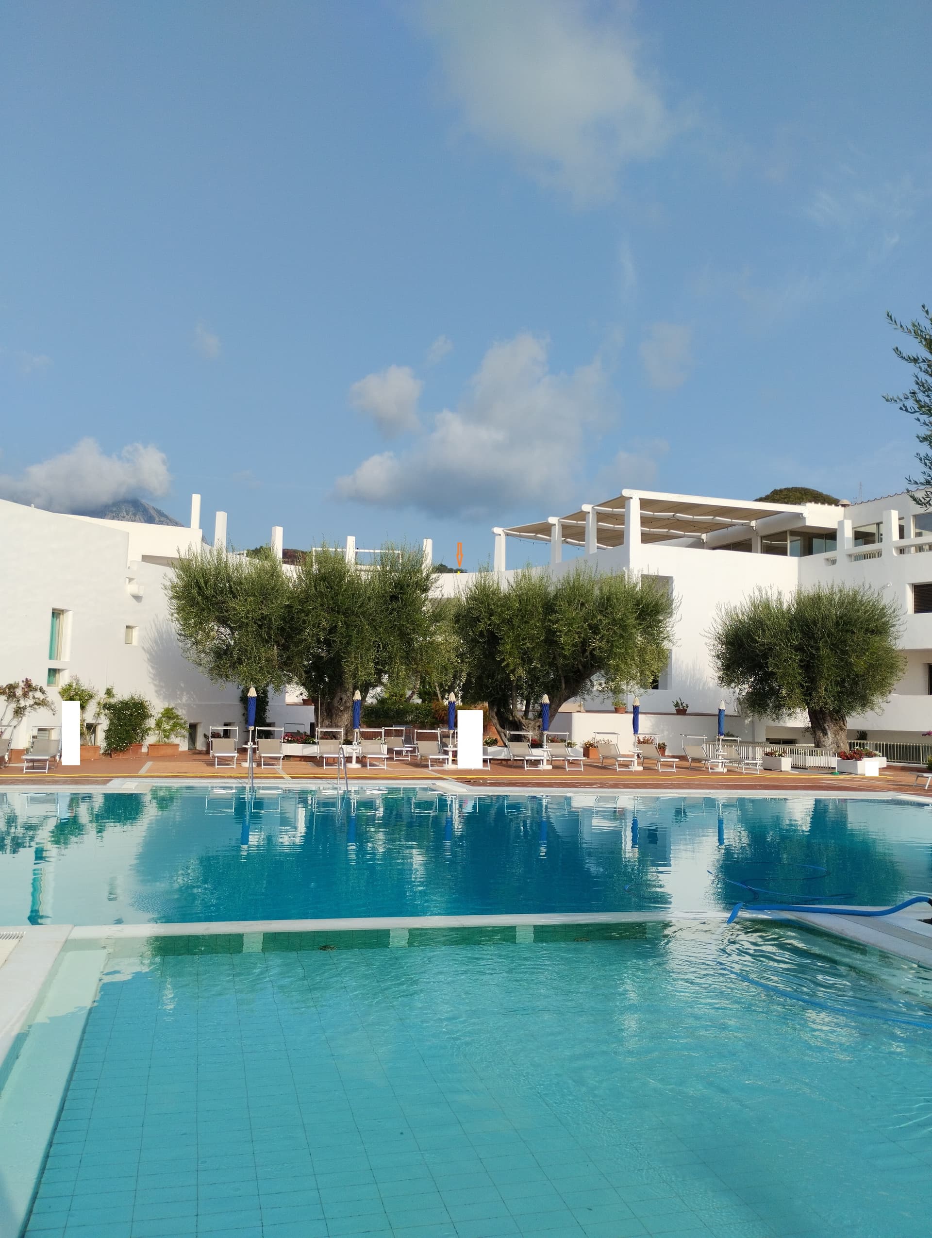

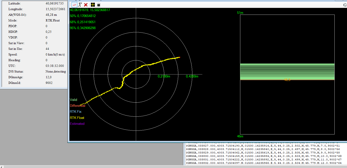

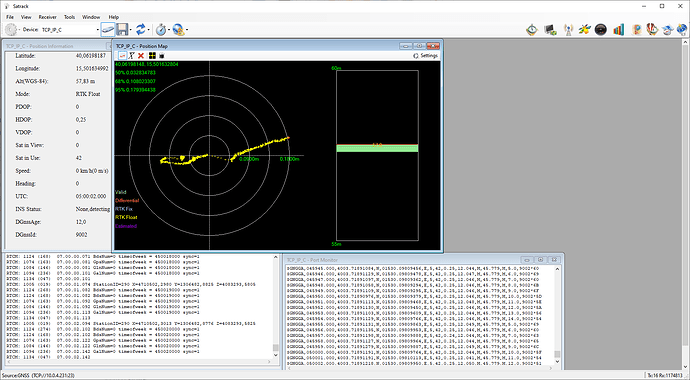

Hi folks here 40 min of PPP_HAS on a static point!
next time in a thick chestnut grove…cheers.
Thanks @Bamarcant
I have data collected but haven’t been able to analyze it.
Lack of time.
  1. Are the data you present from two different points? I see differences in the coordinates.
  2. What antenna are you working with?
  3. Is the program you’re using free or paid?
In short, is the position obtained a fixed position with Galileo or is it still floating? That’s not clear to me.
Angel
