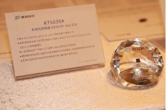

As far as I know - I can say that the chip contained in the LG290P module was conceived at the university by Prof. Lu Mingquan and sold as Kaixin Technology Kisilicon KT5030
