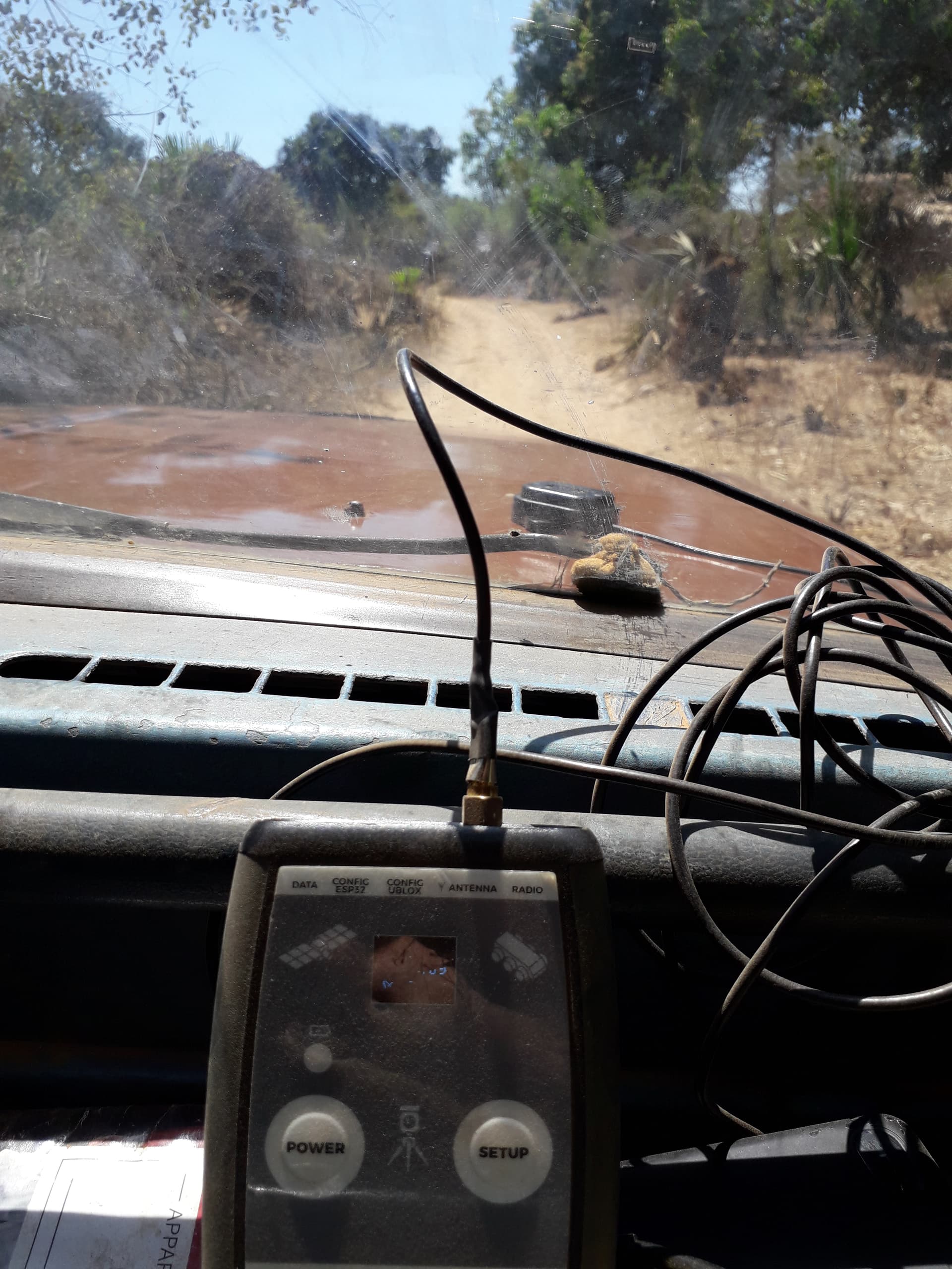

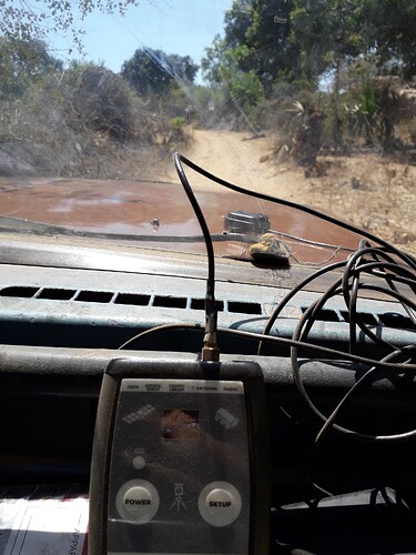

BTW, recently, I was driving far, far away (no SBAS coverage), with the RTK Express (F9P), the u-blox antenna sticked on the engine hood and no RTK correction.
Indeed, the F9P was indicating uncertainties between 25 and 35 cm. I will try to check latter on static stays what was reel dispersion.
Anyhow, to asses HAS performances, we have to compare single positioning to the one with HAS supposedly activated.
Imho, @clive1 correct me if I’m wrong, the F9P is capable but it (have) not an PPP resolution engine yet…

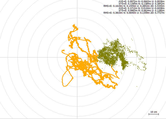

I’ve done a few static tests with the LG290 in HAS mode and a Unicore UM980 attached to the same antenna. The LG290 HAS positions seem reasonable. Here’s a 27 hour plot (RTKPLOT) showing the light colored LG290 data and the darker UM980 HAS positions after twenty minutes of convergence. The graph is centered on a ITRF2020 OPUS position (27 hours).
This is a NMEA GGA sentence plot. Note that the Unicore data is biased about a third of a meter to the east. It’s a bug in their firmware where the NMEA data is not in the ITRF2020/WGS84/Galileo Reference Frame it should be. Their PPPNAVA message will (usually) be in the correct datum so just think of the plot being shifted about a third of a meter west with that message.
It’s just a one day static test, but the LG290 has a little more noise in the data. Not surprising given the heavy filtering. Even so the horizontal error never exceeds a half meter.
Location is the center of North America, a good though not perfect GNSS site, essentially default receiver settings, and a Harxon GPS1000 antenna was used.

@jpb, that’s very valuable “real-world” data for the LG290P, and outside the “claim” of ~20cm for HAS. I have no opinions as to where the snag might be (HAS service, the chip’s implementation of it, a bad day for space weather, etc).
RE: UM980 - I had to make a change in the Torch FW to remove the East Bias, back in January when I was tinkering with HAS on the Torch:
CONFIG PPP DATUM WGS84 [ From SFE ]
changed to
CONFIG PPP DATUM PPPORIGINAL
