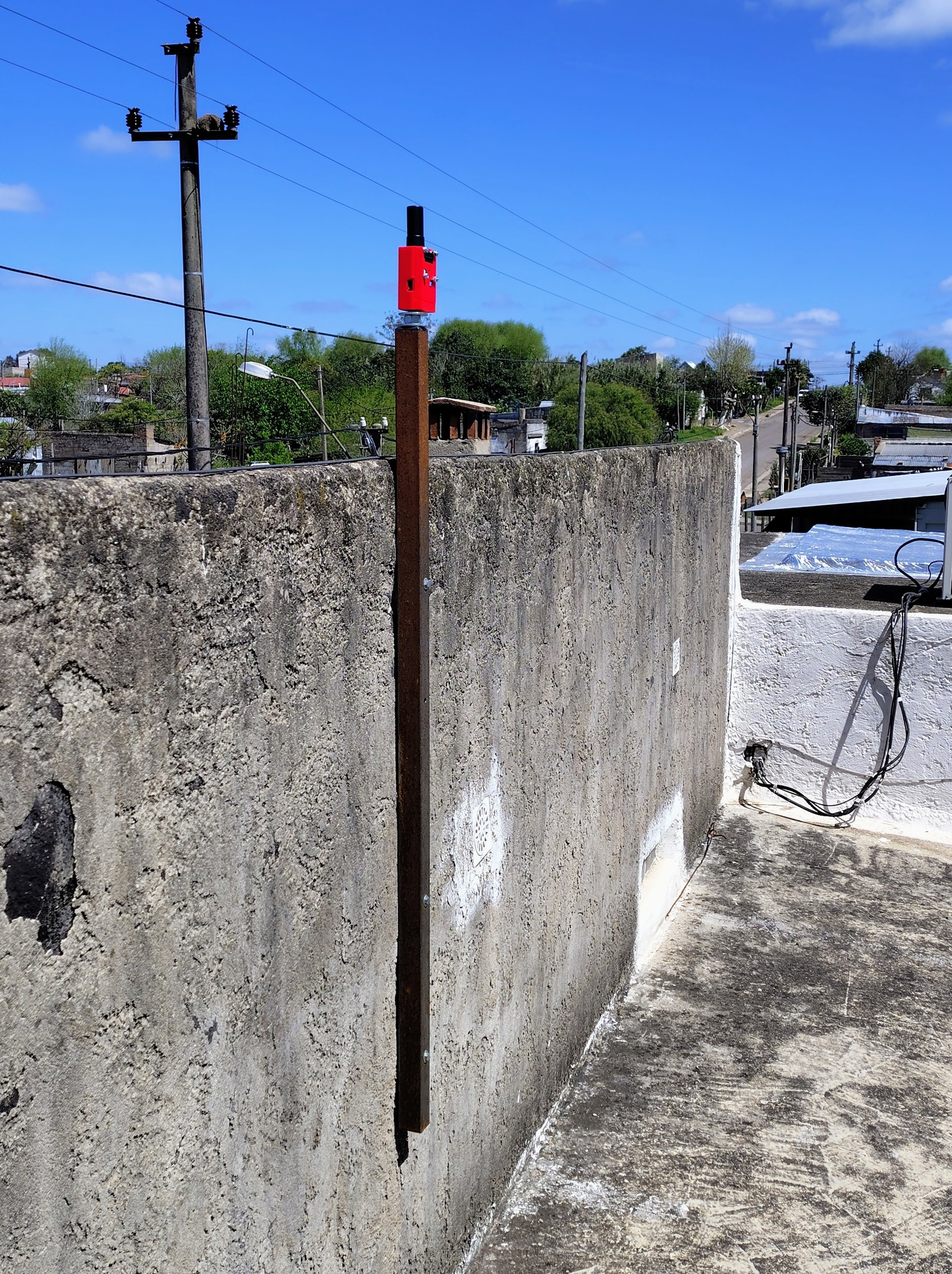

Hi everyone.
Today, February 7th, I have bad news regarding this issue.
Postcard with portability shield.
Elevation mask 10 degrees.
All 4 constellations enabled.
Since last night, I haven’t been able to get good results.
Most of the time, it’s between 35 cm and 60 cm, and sometimes more.
The differential age was sometimes over 15 seconds, and sometimes I ran out of corrections and started again with the infamous 15 minutes or more.
Now I’ve been taking data for 2 hours, and it never even got close to 20 cm. It’s been 35 cm above and sometimes close to 1 meter.
What happened?
What changed between 2 days ago and today?
Is something wrong with Galileo?
Regards, Angel
PD What’s confusing is that the reported accuracy is less than 10 cm, sometimes only 2 or 3 cm.
Hmmmmmmmmmm. ?

I honestly don’t know what’s going on today.
There are random disconnections, meaning the Galileo Hass corrections are being lost.
The point is on the roof of my house, where the visibility is excellent.
In other words, the view of the sky is very good.
Today there have already been four loss of corrections. Two days ago, the differential age didn’t exceed 12 seconds and everything was working fine. Today, as I mentioned, it’s around 15 seconds, and suddenly the corrections stop being received, and we have to start all over again.
Of course, the point is an iron mount screwed to the wall, as you can see in a previous photo; it’s very secure.
I use it as a base when I go out to work.
…sí pero no te cuesta nada poner un refractor agujereado, en cuanto a la línea de alta tensión,podría afectar no poco, pero repito hay días no aunque el cielo esté despejado…
Por qué (ya que la posición es fija), no usar el módulo como base para un lanzador ntrip?
Hi Marcos.
Everything you’re saying is helpful.
But today the results are very bad.
Even with the high-voltage line, I was getting acceptable results with HAS every day. The data I’ve mentioned and shown in this post and others…
That point is my base point, and that’s where I place my equipment to send corrections via ntrip. It’s correct. The location works very well for me.
Regarding the disk, I didn’t think I’d need it, and I’m going to try to get one for testing.
We’ll see what happens throughout the day.
I’ll keep you posted.
