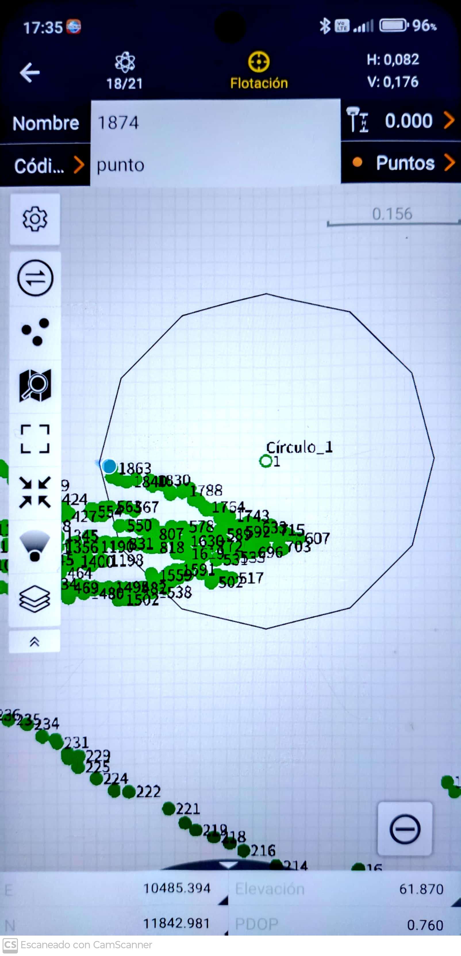

My problems these days seem to be atmospheric.
Yesterday, as night fell, I had a good series of data, with average distances to the base point of 10 cm.
Today, during peak tecu hours, the problems and disconnections from the HAS corrections returned.
That is, randomly, I would stop receiving HAS corrections.
Later they would come back, but the accuracy was never good. Always above 35 cm and up to 1 meter, even though it indicated accuracy of less than 10 cm.
PD I forgot to mention that I put a metal plate on the antenna, as suggested.
