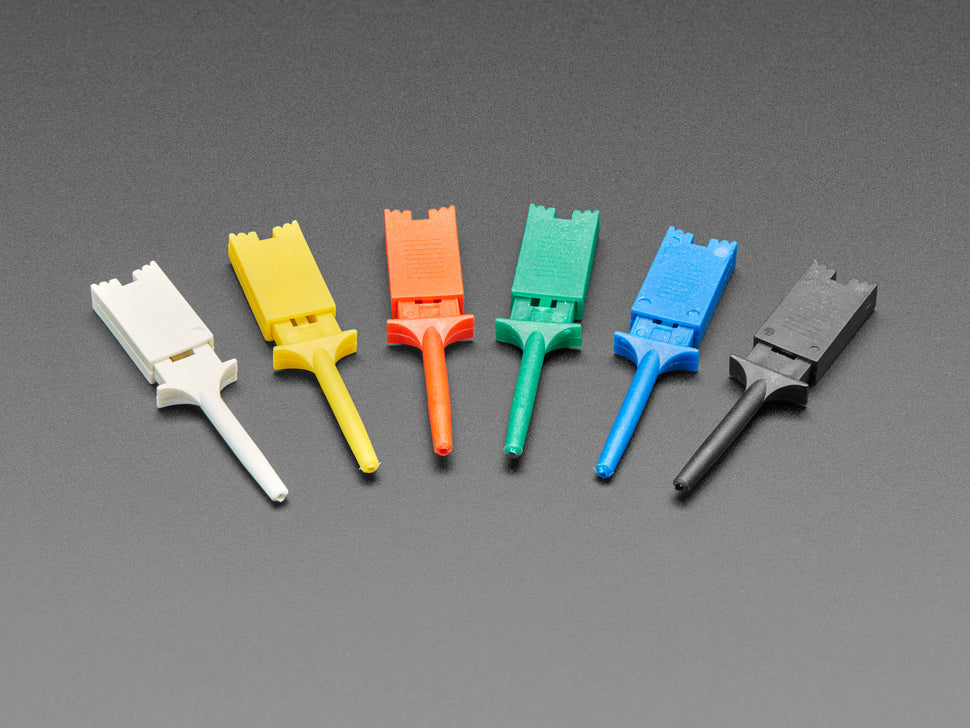

Hello.
What I want to do is to ask to a pcb maker to create the BBQ20_USB_Keyboard for me (because it is sold out,but I need this nice keyboard for building my DIY phone)
The BBQ20_USB_Keyboard comes equipped with a blank RP2040 with nothing written to it.
I will need to write firmware to it.
It’s not difficult, though. The Raspberry Pi Pico RP2040 uses an excellent and simple method for writing firmware.
When I connect it to your PC via USB while holding down the BOOTSEL button, it will be recognised as a USB memory stick. All I have to do is place this file there.
However, there is a major challenge for me.
The BBQ20_USB_Keyboard board does not have a BOOTSEL button…
h t t p s : / / i b b . c o / H L S g L 3 R h
With a regular Raspberry Pi Pico, I simply press this button…
h t t p s : / / i b b . c o / n N 5 J 3 d c 7
With the BBQ20_USB_Keyboard l need to connect those two round metal terminals on the back of the board. But ZitaoTech (the creator of the keyboard) didn’t include that button.
If a tool like this one :
were narrower,it could work to electrically connect the BOOTSEL test metal terminal and the GND terminal while I connect the USB.
Someone can help me to find the narrower version of the alligator clip ? thanks.
Does this work?
This is not the keyboard that I’m going to buy,but that button is present also on this one :
Try that same sequence and see if that works
If you want to try your original request, you might like
or IC Hook Test Leads
Is this good in your opinion ?
Nope, ours are the good ones :-p
Mini test and jumper clips OP describes seem to be called ‘logic analyzer test clip’ or similar.
