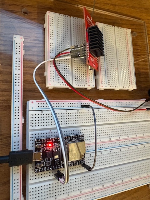

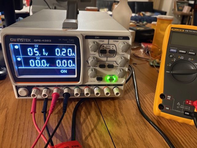

Hello Paulvha,
I removed the M7e board from the breadboard and connected it directly to the soldered to the header pins as shown in the attached picture. The connection now is good.
Replaced the breadboard 5V supply with my Lab power supply (GW Instek DC Power Supply) as shown in the attached picture.
The board worked fine and was able to read tags with the example sketches.
The problem of the “Module Failed to respond” keeps recurring now and then.
There is something definitely “flaky”. I will keep trying for some more time to identify the root cause.
I would also like to explore the possibility of sending the M7e to you to check it out.
Thanks for all your help.
Chandra

Can you post some clear up-close photos of the soldering? It’s hard to tell but the m7e looks like it might have dark spots or maybe flux or something?
Is your power supply only setup to deliver 0.2 amps? I’d up that to 2.0 and see if things get better.
The M7E, like the M6E, is VERY sensitive to a good power supply. As soon as you start reading it works in “bursts”. A standard wall wart will NOT do it. You need a “lab” power supply that has enough capacitor power to handle these bursts. Many articles about it on this forum.
For the intitial start-up with connecting and only to read the hardware / firmware should not be a problem. Instead of using external supply, just connect directly to the ESP32. The less wires, the better. Also try with lower RFIDspeed (e.g. 38400).
Does the M7E work without problems on USB with the URA from Jadak/Thingmagic, then your M7E should be good. Working with USB is just adding the on-board USB/Serial convertor.
Thanks for your suggestion and sorry for the delay in responding.
The current limit is set at 1.3 Amps. What you see in the picture is the actual current draw at that time.
The unit is working fine, and I will switch to a separate power supply next month.
