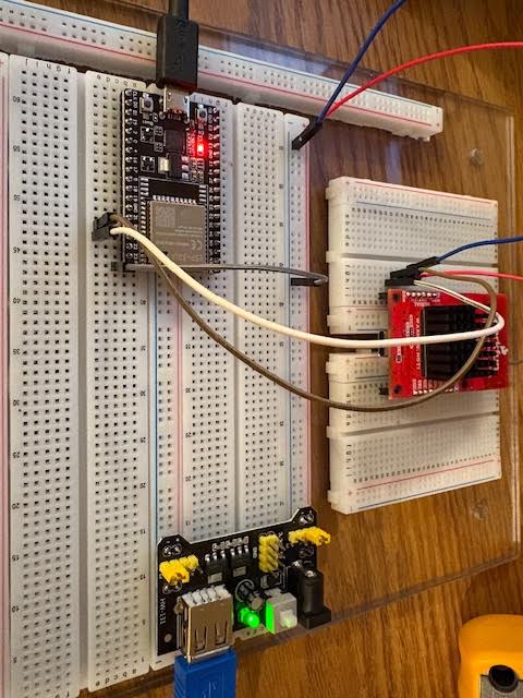

Are the connections soldered? Can you share a photo of the wiring/setup?
How is the m7e being powered? If you have the esp32 also powering the reader then that is likely the issue Basic Assembly - SparkFun Simultaneous RFID Reader - M7E Hookup Guide
Hello Russell,
Thanks for getting back to me.

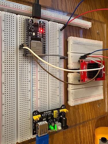

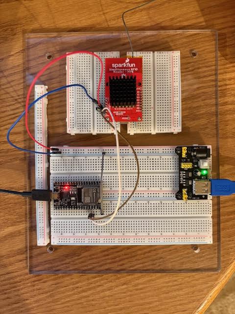

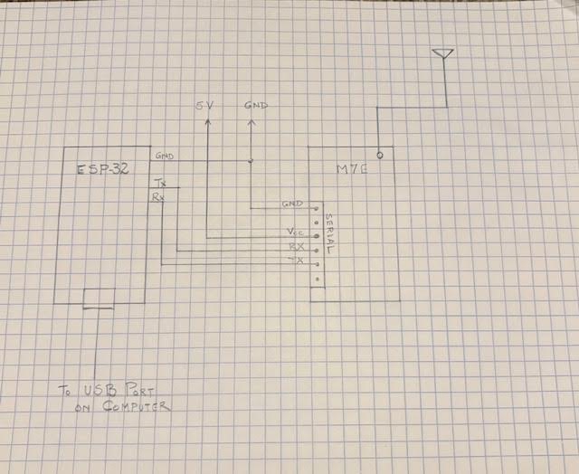

As you can see, the headers are soldered to the boards and pushed on to the breadboard.
I have attached a connection diagram, and two photos of the setup.
I have tried swapping the TX and RX without any success.
I am confirming the UART slider switch is on “SER”.
Please let me know if you want me to do any other checks.
Thanks, and appreciate your time.
Connections look good…I’m suspicious of the usb board there
Can you swap to powering via the barrel jack instead of the blue usb cable? What are the specs on that converter?

It is hard to see from the pictures, but 2 remarks:
Looking on where M7E is connected, Is that really GPIO16 and GPIO17? There are many ESP32 boards layouts, but I get the impression it is GPIO1(TX0) and GPIO3 (RX0). The layout of your board looks a lot like ESP-32 Microprocessor – DuinoKit
Is the power led on the M7E ON ? Can’t see that on the picture as it is underneath.

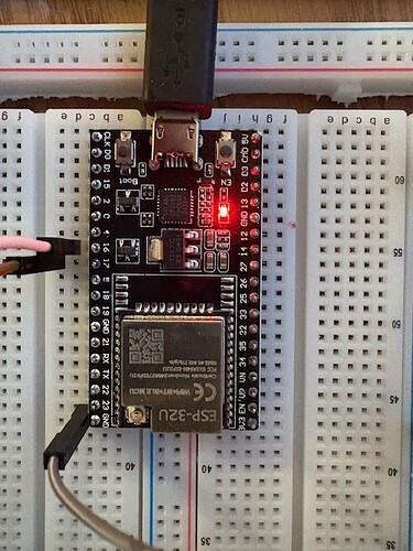

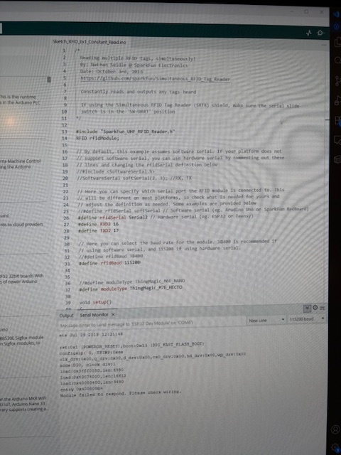

can you make a clear picture, top view, of the ESP32 connection ? As a mentioned i am concerned they were to NOT connected GPIO16 and GPIO17 according to the board layout ?
Hello Paul,
I am attaching photos after I moved it to pin 16 (RXD) and pin 17 (TXD), and the results were no different.
When I had it connected in the earlier configuration of pin TX and RX, it was defined in the sketch as RXD 3 and TXD 1. Still had the same “Module failed to respond. Please check wiring.” message.
In both configurations, swapped TX and RX lines with the same error message.

Looks you now have GPIO16 and GPIO17. The RXD -3 and TXD- 1 are Serial (same as USB). So don’t use those. Indeed try to switch exchange (although the brown wire looks to be in the right position) the wires and reboot.
If no success yet :
Connect the M7E GND to the ESP32 GND and the M7E VCC to the 5V, next to the USB connector and try again. Do not use external power supply. As long as you don’t start reading, there is just a low power needed on the M7E which the ESP32 can provide. Check the power light is on the M7E.
If that does not work still to detect.
  1. adjust the Serial/USB switch forth and back again in the serial (it happened in the past it did not connect well).
  2. Else remove the power ESP32 power and reconnect. Once the M7e is “in limbo”, it stays there.

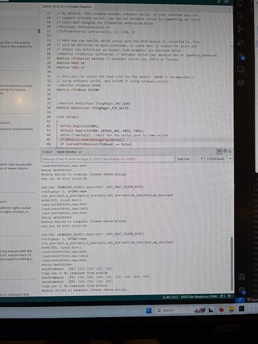

If that does not work make sure to add in setup() before if (setupRfidModule(rfidBaud) rfidModule.enableDebugging(Serial); Then re run and share the serial outcome.
Hello Paulvha,
Followed all your instructions, and the result did not change.
Confirmed the Power LED is ON.
The results with debugging enabled are as follows:
Thanks for your help. Appreciate it.
Chandra
although hard to see, there is NO responds from the m7E on the 2 requests (first and third) for the hardware/firmware information and the 2nd request is to change the baudrate. (there is no responds expected on this one).

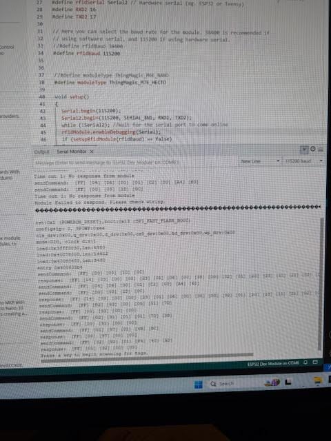

Let’s make it is not a wire issue. Reconnect the RX / TX wires from the M7e and connect only those 2 on a different place on the patch-board. Whatever is sent by the sketch should be received in debug mode
Hello Paulvha,
Kept and jiggling the wires to make sure everything was fine. When rebooted, I has a different response this time. Please see the photo attached.
Hope this helps.
Chandra
can’t read it.. but it looks much better in responds. Looks it is working now.
When you now start reading for a tag.. it might bail out due to power consumption that the ESP32 can not deliver.. at least the basic communication is working
Here it is.
load:0x40080400,len:3480
entry 0x400805b4
sendCommand: [FF] [00] [03] [1D] [0C]
Time out 1: No response from module
sendCommand: [FF] [04] [06] [00] [01] [C2] [00] [A4] [60]
rst:0x1 (POWERON_RESET),boot:0x13 (SPI_FAST_FLASH_BOOT)
configsip: 0, SPIWP:0xee
clk_drv:0x00,q_drv:0x00,d_drv:0x00,cs0_drv:0x00,hd_drv:0x00,wp_drv:0x00
mode:DIO, clock div:1
load:0x3fff0030,len:4980
load:0x40078000,len:16612
entry 0x400805b4
response: [FF] [14] [03] [00] [00] [23] [01] [06] [00] [38] [00] [02] [01] [20] [23] [11] [22] [02] [01] [03] [2E] [00] [00] [00] [10]
sendCommand: [FF] [02] [93] [00] [05] [51] [7D]
response: [FF] [00] [93] [00] [00]
sendCommand: [FF] [02] [91] [01] [01] [70] [3B]
response: [FF] [00] [91] [00] [00]
sendCommand: [FF] [01] [97] [01] [4B] [BC]
response: [FF] [00] [97] [00] [00]
sendCommand: [FF] [02] [92] [01] [F4] [40] [AD]
response: [FF] [00] [92] [00] [00]
Press a key to begin scanning for tags.
yep… it now connects to the M7E and is ready to start reading. See previous remark on potential bailing out. An external supply can help to overcome that
