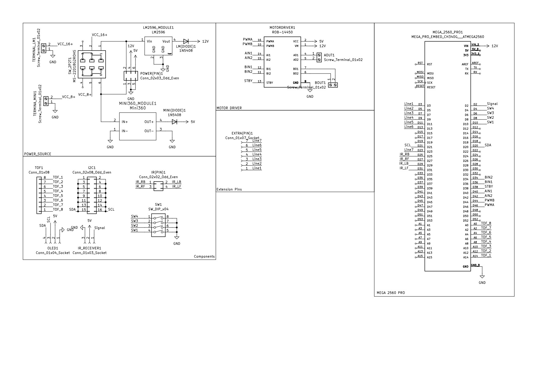

My TB6612FNG just burnt after code changes
I want to know the cause of the error that led to my TB6612FNG burning out suddenly after I changed the code. Attached underneath is the schematic of my connection. So basically what happened was I was testing if all functionality of TB6612FNG works as i was checking if it responded on time and properly to my Time of Flight as the project is a sumobot then when I went ahead and change everything regarding the sensors and went and put only Backward(motor1,motor2,180) within the loop with no delay. My TB6612FNG goes into smoke suddenly, and after that, I can’t use it anymore, and the LM module is making a noise when I turn everything on.

So you’re using 2 motors on each output?
Each output is rated for 1.2 amp, your motors each draw 1.2 amps at stall. I think you’re pulling too much current for the driver.
You could use two drivers and put one motor per channel. The inputs to the driver can be paralled so the motors work in pairs.
