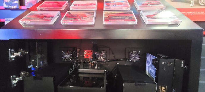

I am having a .wav file playback issue on kiosk-style setup using a Tsunami. I have seven, backlit, vendor-machine style buttons, wired in series with a two-wire trigger coming down from each one. I then have the triggers soldered to seven of the input channels on the board (9-15 in this case) and my plan was to audio out through the 3.5mm output on the board, which I can hear activated through the Sony A/V Receiver, pro bookshelf speakers and sub inside of the cabinet.
The idea is to press one the seven buttons to hear a 10sec .wav file audio clip. I reviewed the stereo and mono versions of the files sent to me with Audacity and they apper fine, and I renamed them corresponding to input - 009_Number.wav, 101_Number, etc. I cant get any audible playback from anything, and I tried the Tsunami Wav, Tsunami Stereo and Tsunami Mono versions of the software just in case.
HELP! This is a major corporation and my brand reputation is under a microscope. I had faith that Tsunami would be the perfect solution for this application, but I don’t know what the final piece of the puzzle is that I’m missing.
I’m on the line with Jamie Robertson as well, casting a wide net to get this done! He told me that the file needed to be 44.1kHz, 16-bit mono to play properly as configured with the software, but I’m getting pushback from the client that they don’t want to do that and will bring in someone to replace this solution with an Arduino-driven one. This is a huge hit for the reputation of my company, and I’m mad as heck right now over this!
Gratefully for any help, happy to jump on a call or text, or to send more images or files….Whatever it takes!

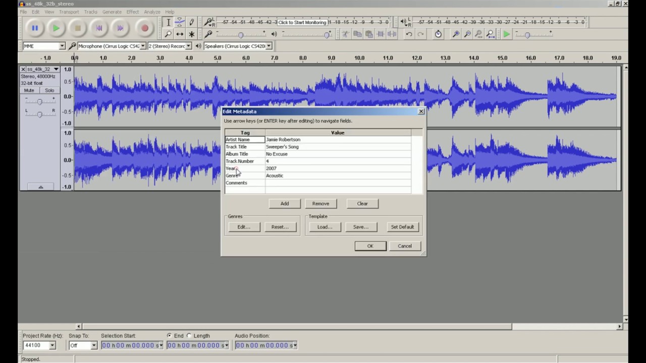

Is there any metadata in your files? If there is, they won’t play. The video below shows how to strip out metadata from your files with Audacity.
You might also have a look at the Sparkfun hookup guide and Robertsonics user guide, both have information that should be helpful.

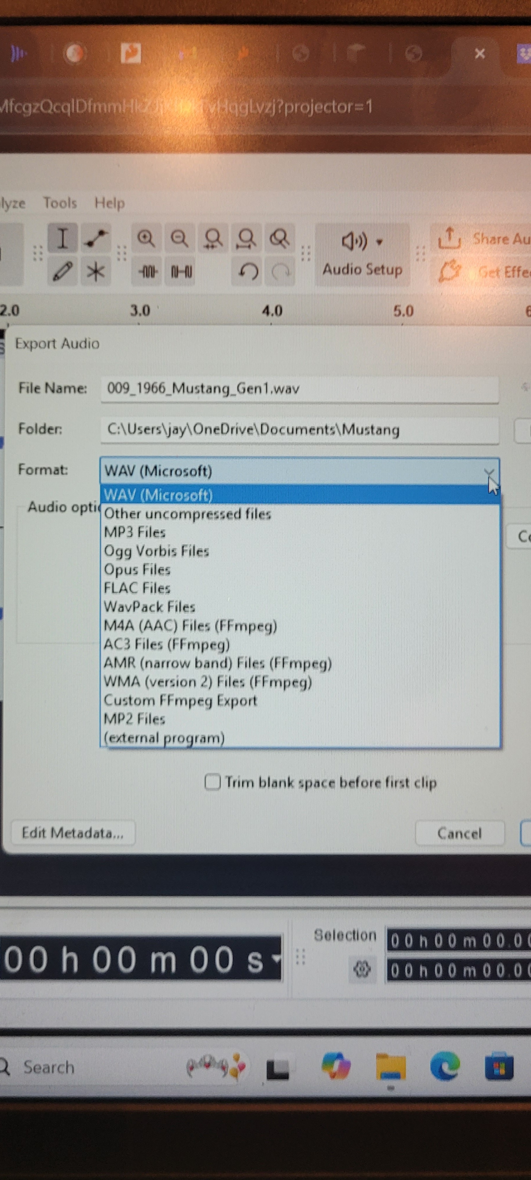

I watched the video provided @YellowDog but don’t have an exact match in his reference to saving the file type. Any advice on which one I should select given the lack of a “WAV (Microsoft) signed 32-bit PCM” as the video indicates?
These are the options my Version of Audacity currently displays…
If this were my project, I’d get it to a baseline working state with the stereo FW and the demo wav files. Then, assured that the device & firmware is ok, my focus can remain steady on the client’s file conversions.
Almost at bottom, pianodemo.zip:
I’m not anyplace where I can load up the latest version of audacity to try, but give the “microsoft” entry a try and see if it works.
My guess is they changed the user interface in audacity since the video was made but it’s still the correct settings.
Just downloaded latest version of Audacity. Now it’s: File→Export Audio→Export to Computer.
Format: WAV(Microsoft)
Channels: Mono or Stereo
Sample Rate: 44100
Encoding: Signed 16-bit PCM
There’s an “Edit Metadata” button in the lower left that’ll let you delete any metadata if there is any.
