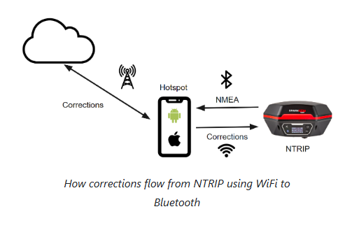

It was, but the PointPerfect L-Band service was sunset in December :-/
Did you sign up for PointPerfect Flex, which is active?
Generally speaking, you need to enter those NTRIP credentials into your GIS app. The GIS app then passes the corrections over Bluetooth to the RTK device. Docs for the FPX-T are here, namely checkout the quickstart guide showing how to use the NTRIP Client in SW Maps.
(Above) If you want to get technical, you can also enter the NTRIP credentials into the FPX-T unit itself, and then give the FPX-T WiFi credentials to the hotspot on your phone, but that’s usually only required for iOS users or other cases where the GIS app does not have an NTRIP Client built in. Docs are here.
Also note - we’ve split SparkPNT away from SparkFun. If you need technical help with your FPX-T, please checkout the SparkPNT forum - but don’t worry, we’ll help you wherever you are.
