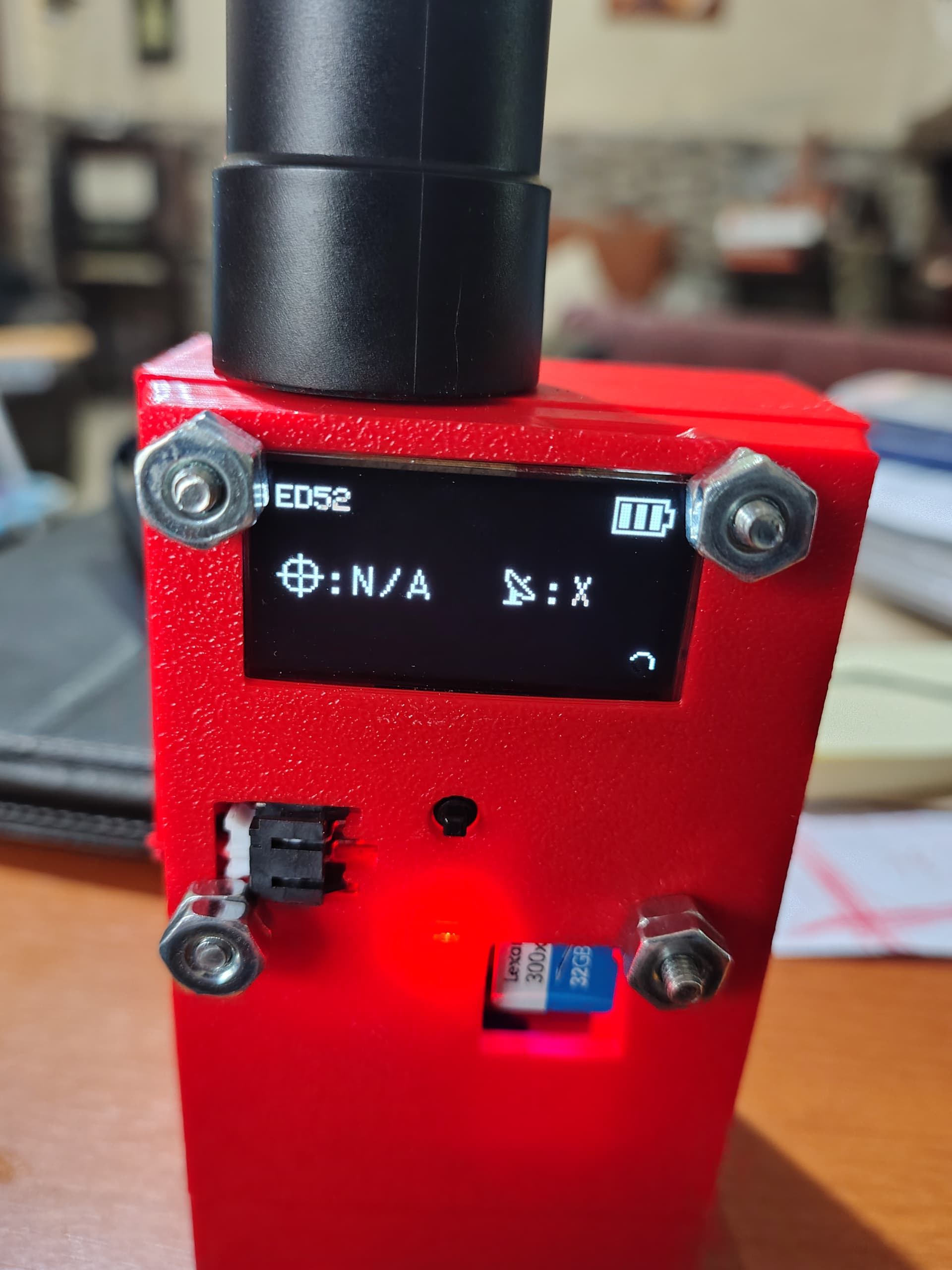

Postcard RTK with Portability Shield (v2.2)
When I configure the Postcard via Wi-Fi configuration, after making the necessary changes and requesting a reset, it restarts, but there’s a GNSS and Bluetooth failure.
Every time I’ve configured via Wi-Fi, I get the same error during the restart.
The solution has been to reset the Postcard using the button several times until the restart is successful and it enters rover mode.
I’ve also solved it by connecting and disconnecting the power several times.
If I configure via Bluetooth, I generally haven’t had any problems.

Hi, I really need help from Sparkfun.
As I said in the first post, after configuring the Postcard via Wi-Fi, after the reboot, it wouldn’t enter rover mode and the Bluetooth light remained solid blue.
The portability shield screen says precision n/a and satellites n/a.

Yesterday I configured via Wi-Fi again, and it freezes again, I can’t receive any satellites, and the Bluetooth light remains solid blue.
We need to see what’s happening with this problem, as yesterday I had to disassemble the entire device until, after a reboot, it booted into rover mode correctly.

Hello, I’m updating the problem.
As of yesterday, July 10, I got another error when starting the postcard.
In rover mode, it takes a long time to start and doesn’t report accuracy or satellites. It says n/a for the satellites.
The worst part is that I don’t have access to Bluetooth because the blue light stays solid and it doesn’t connect.
Since I have the postcard in a fixed case, it’s hard to disassemble it to do a manual reset with the rear button.
The solution was to reinstall the firmware, erasing the flash drive.
After the reset, everything returns to normal.

Hello @sparky @PaulZC Postcard v2.2 del 11/07/25
Hi, emphasizing my problem, I’m sending the video with the error. The video has a .txt extension, but I can’t upload it as an MP4.
