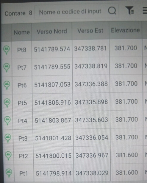

I found that the GPS-RTK-SMA ZED F9 - P card returns a series of equal heights, even though the real situation is different +/- 10 cm, I ask if it is possible to modify the sensitivity to a higher precision. I attach a screen of the points taken

good morning, I changed the variable to high precision, but it only adds one digit, unfortunately I am a surveyor and I have no skills in ublox, I checked in the field software and the precisions are within 5 cm, I attach a screen. I do not understand why it records the height with a 10 cm step, can you help me thanks !!

Is it reporting Minutes to 7 decimal places in the NMEA output? That should resolve sub-cm. The height should be metres to 3dp, for the “High Precision” reporting.

What is the software?
My guess is that’s a result of your Software.
Could be the resolution of the gridded Geoid File (if used) and the app is dropping digits after the Ortho Calculation (which is incorrect). It’s unclear if those are Ellipsoidal or Ortho Heights in the Screenshot.

the problem occurs on both surpad 4.0 and FieldGenius

the coordinates are in the utm33 reference system, the x,y position works very well with centimeter precision

But despite the update, the measurement persists every 10 cm. The card’s technical specifications specify accuracy of 1 cm on the three xyz dimensions. I can’t figure out why I can’t achieve this level of accuracy. Perhaps it has something to do with the acquisition frequency?
