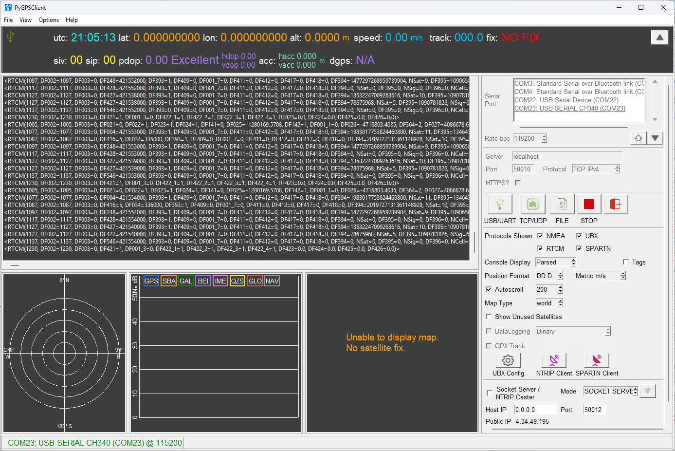

Above, we used pyGPSClient to inspect the RTCM coming out of the BlueSMiRF, it eats it up (looks fine).

Back to the X20P: Now if we connect Android phone + CH340 to the X20P UART2 RX pin, it works. Why does a wired connection work on UART2 of the ZED-X20P but not data coming from an ESP32?

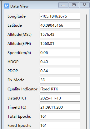

Above, perhaps it’s serial timing tolerances? So we changed the ZED to 38400 (both UARTs) and the BlueSMiRF to 38400. The same: UART1 is happily connected to the BlueSMiRF over BLE and RTCM is received and RTK Fix occurs. Moving the wire to ZED-X20P UART2 RX pin, the ZED just skips all data coming out of the BlueSMiRF.

Ahah! There’s a high voltage limiting 1k resistor on that connector (BlueSMiRF and locking JST) that is causing the issue. If you jumper around that, BlueSMiRF works great (which also explains why the CH340 worked = bigger driver). So you can either jumper over the resistor, or connect the BlueSMiRF to the RX2/TX2 pins.
