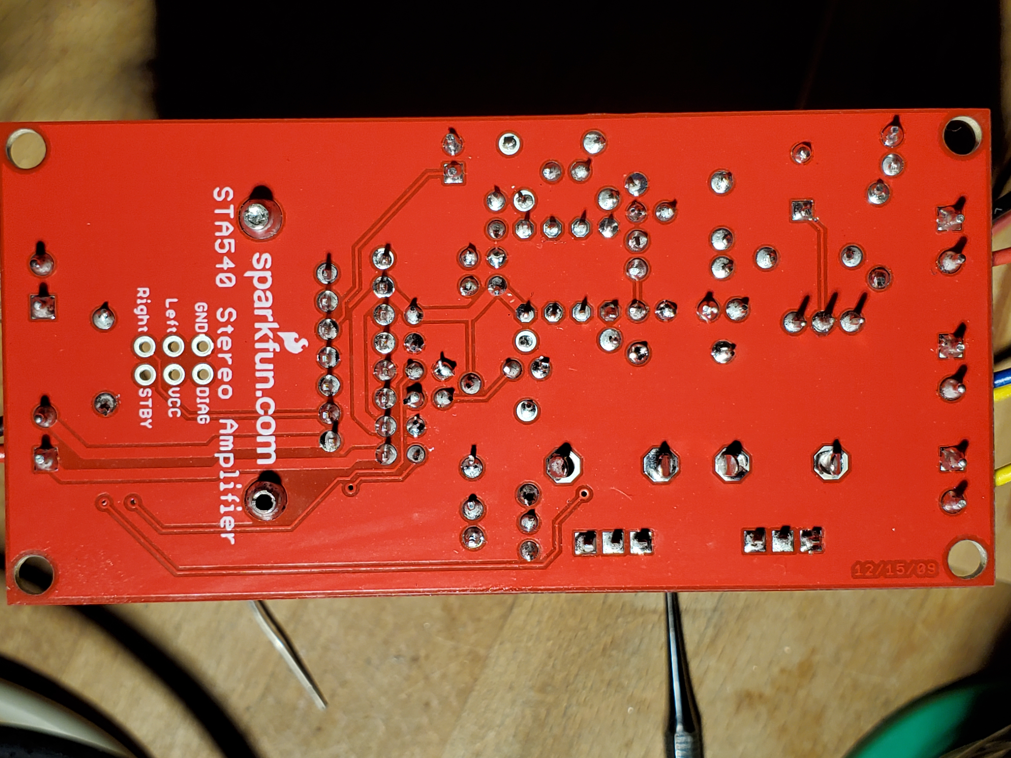

    Can you send a clear photo showing the bottom of the amp board?
    with a deep-cycle Marine battery, the popping noise does not occur, but the right side of amp is not working. Confirmed that popping noise only occurs on right channel when using my power supply. Left side amplifies fine. Current consumption when using battery is about 110mA with no sound being input. With sound goes up to roughly 140mA. Photo of back of board is at http://www.powersoft.ca/files/20210408_182425.jpg
    OK, that confirms your power supply isn’t quite up to the task of running the amp, I know it says 5A on the label but I suspect it’s not able to deliver that much.
    It’s hard to tell from your photo, but I do see one suspect connection that’s in the right channels audio path through the board, you might want to try touching that up and see if things work on the right channel then.
    Another thing you might want to check is disconnecting the right channel input from your audio source and connecting it to the left channels input, that way your sending the same known working audio to both channels. If that does the trick, you know the issue is with the audio source and not the amp.
    Last thing to check is your right channel speaker. Try swapping the speakers and see if the non working channel switches from the right to left side.
