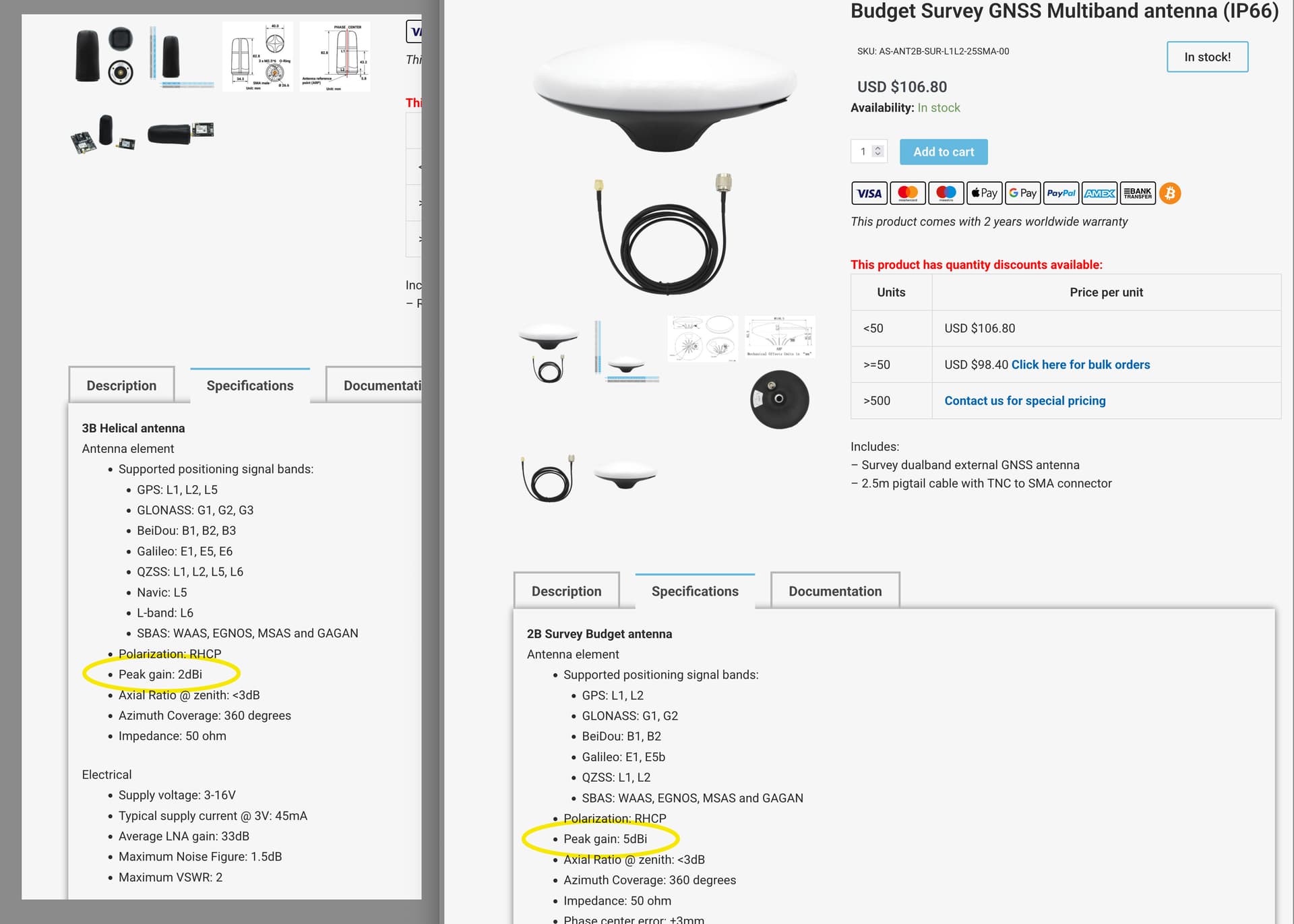

Cael,
If you are using the small black “can” helical antenna, that antenna is not a particularly high “gain” antenna. In my prejudiced stereotype those “can” antennae are designed for drones with an open view of the sky. The larger white “flying saucer” antenna below has twice (+3dB) the gain, which may help help you maintain adequate signal reception under tree cover.
From Ardusimple’s website:
If one is standing at the base of the trunk of a single mature oak, pine etc tree in an open field, one still has large amount of tree mass blocking the signal from directly overhead, and a very large mass of tree trunk blocking the signal from any satellites on the other side of the trunk.
I don’t know what the “professionals” do, but I would be tempted to cut an 8ft or 3m piece of thin lumber like a 1x2 and affix a compass to it and take my location measurements offset that distance from the trunk along magnetic north or south, and fix the data later “in post”. That offset might be sufficient to get you out from the signal shadow of the tree.
