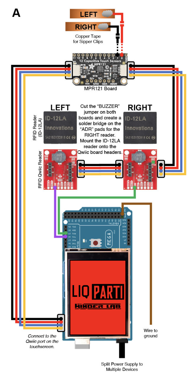

Hello. We’ve previously used the SparkFun RFID Qwiic Readers without issue, but are struggling with undercounting RFID scans and occasionally scanning an nonexistant (repeated identical - 3102000232) tag across multiple devices.
We have not changed anything about the code or build, but did notice that in our most recent batch of RFID Qwiic Readers, the addresses were changed (we’ve updated these from 7D/7C to 13/14 in our code accordingly and detect the readers just fine). It looks like new firmware was also updated on these new readers.
What is different about the 2 readers so that we can better troubleshoot our issues?
Are you using more than one RFID reader on one i2c bus?
Are you using python?
We are daisy chaining two readers, so I think that counts as running 2 on 1 I2C bus. Wiring diagram is attached if I am incorrect on that point.
We are not running on Python. We use the Arduino IDE.

Alrighty - have you disabled all but one set of pull up resistors on the i2c bus? You accomplish this by severing the traces labeled “i2c” in this photo (using an exacto knife or similar), be sure to leave only one set intact and re-try
Ah, when we tried that previously, we severed those jumpers on BOTH readers. We will try that tomorrow and let the systems run overnight and get back to you.

Unfortunately disabling all but one set of pull up resistors on the I2C bus did not resolve our issue. It actually appears to have made it worse on some of our systems.
