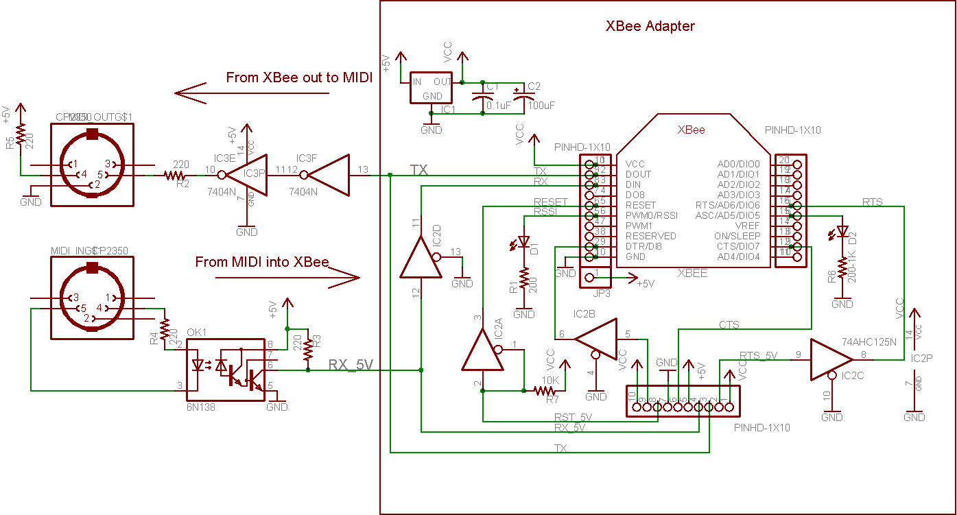

Now here’s the strange part - the second XBee only transmits the data it receives over wireless when the COM port is open. (I can see the RX LED flash on the Sparkfun board).
This is easily replicated in X-CTU - when I press the “Close COM port” button in the Terminal, the data stops flowing (RX stops flashing) in about a second.
Changing the assertion of DTR and RTS doesn’t do anything - so I’m wondering how else the XBee knows the port is open or closed?
If I set ATD6 to 1, then it responds to RTS flow control perfectly (i.e. it stops sending the received data instantly). But this is not what I want.
Ultimately, I want to move the XBee into its own dedicated circuit and for it to always send the received data regardless of whether anything is connected.
How can I accomplish this? AT settings or hardware solutions work for me.

Not sure I follow - According to the XBee Manual, Figure 2-03, /CTS is an output from the XBee to the host to say that the DI buffer is nearly full.
But I’m not sending data from this XBee - it’s for receiving only. To clarify,
I built this (transmit only though): http://www.ladyada.net/make/xbee/midibee.html
This works perfectly - I can see the data just fine. RSSI and RX on XBee #2 are both lighting up.
Arduino -> XBee#1 -> Wireless -> XBee#2 -> XBee Explorer USB -> PC -> X-CTU
But, when I move XBee#2 to the proto board on an XBee Explorer Regulated, RSSI still lights up but DOUT does not:
Arduino -> XBee#1 -> Wireless -> XBee#2 -> XBee Explorer Regulated -> MIDI Out
I’ve tried forcing RTS both high and low, no luck. There must be a better way?

Schema:

Oh, I know the terms, just a bit rusty. So at the application level, I've limited the Transmitting XBee to 19200 bps, and am carefully controlling the send rate (3 bytes every 100 milliseconds).
The problem is, on the Receiving end, there’s no “DTE” per se - it’s a MIDI synthesizer. And the article doesn’t mention flow control at all, so I’m wondering what I’ve missed.
Here’s the schematic, and it looks like RTS and DTR are forced high - maybe my board is different, need to check.
http://www.ladyada.net/images/midibee/midibeebb.png
CTS goes to a pin header and seems to have no pullup.
As I recall, you can config XBee series 1 to ignore CTS.

Hardware flow control is usually done with CTS (clear to send). Receiving end takes CTS false and within a few character times, data should stop flowing. But only if the sending end implements hardware flow control and has it enabled.
RTS (request to send, not "ready to send) is not used for flow control unless modems are in the loop.
Much wiser to NOT use hardware flow control. Race conditions galore. Better to have the application messaging do blocked data flows with an application layer flow control. Or use a network layer on fancier systems (e.g., DigiMesh on Series 1).
