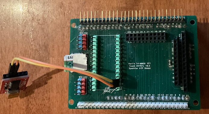

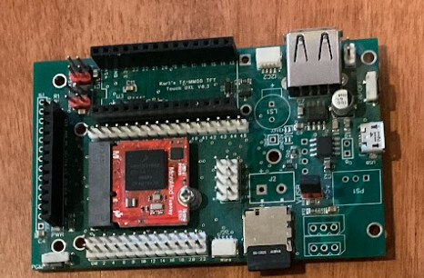

For what it is worth, when the Teensy Micromod was in beta or maybe maybe just after it released, I did my own board for the Micromod… (Only board I have done that I had it partially assembled due to how small pads are…)
But it is probably overkill for your needs, but things you might consider…
I have socket that allows me to plug in T4 size things, in particular I can plug Audio board into it.
All of the IOPins - with Teensy pin numbers shown…
SDCard - it is setup with SDIO.
USBHost - you already mentioned you don’t need
Display Connections:
One is setup with the pinout of the ILI9341 that PJRC now Sparkfun sells? It also works for ILI9488 and ST7796 displays
The other has the Adadruit display breakout, that I have used for ST7789/ST7735…
This has been my goto board for Teensy stuff for several years.
However not that long ago I was playing with Micromod with different cameras, and did a quick and dirty plugs into the ATP, which again has SDIO, Camera and the displays…
Again overkill probably for your needs…
