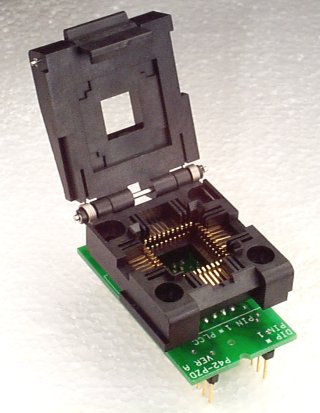

I’m going off on this tangent, here, but do you know offhand of a socket that would be good to use on a programming station for adding and removing 44 pin SMD PICs? I see lots in my Mouser catalog in the 1 dollar range (sounds too cheap to me) but I’m not sure if those are the right kind. Thanks a lot!

They’re almost certainly not what you want, since ZIF sockets of that size usually cost around a hundred dollars. What kind of packacge are you talking about?
You’re talking about something like [this right?](http://www.logicalsys.com/prodpics/p42z.jpg)
Yes, that’s what I was thinking of but now come to think of it, it probably is better to be able to program the chip after it’s on the board. If so, I think I am ready to move forward on this. Everyone here has really been so helpful I can’t believe it. I’ll keep everyone posted on my progress. Thanks again. DJ
I add 10 pin icsp programming header for all of my proto designs. I use an melabs serial programmer and will probably buy one of these zif tqfp sockets soon. And yes I do use smt for most of my prototype work. Bare pcbs (sans soldermask) are great for this.
