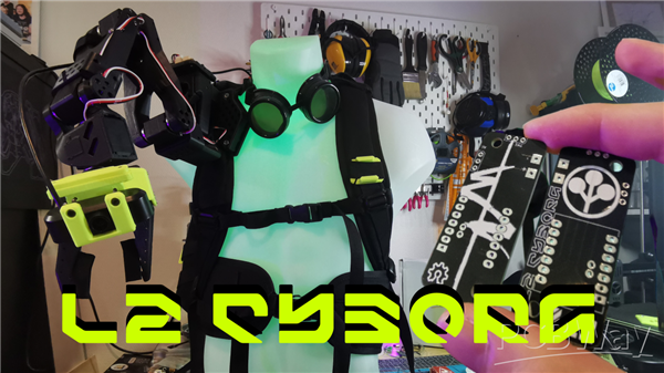

You can use a LiPo battery + a proven charger/boost board that explicitly documents “power while charging” (Adafruit PowerBoost/PowerShield is one example), and size the battery and boost current for worst-case draw. Put a thermal sensor or current fuse in the battery compartment and design the 3D printed cavity to prevent direct skin contact with hot surfaces. Test behaviour while charging at your expected load to confirm the charger doesn’t throttle or become unstable. You can also explore this EMG third arm prosthetic arm project.
