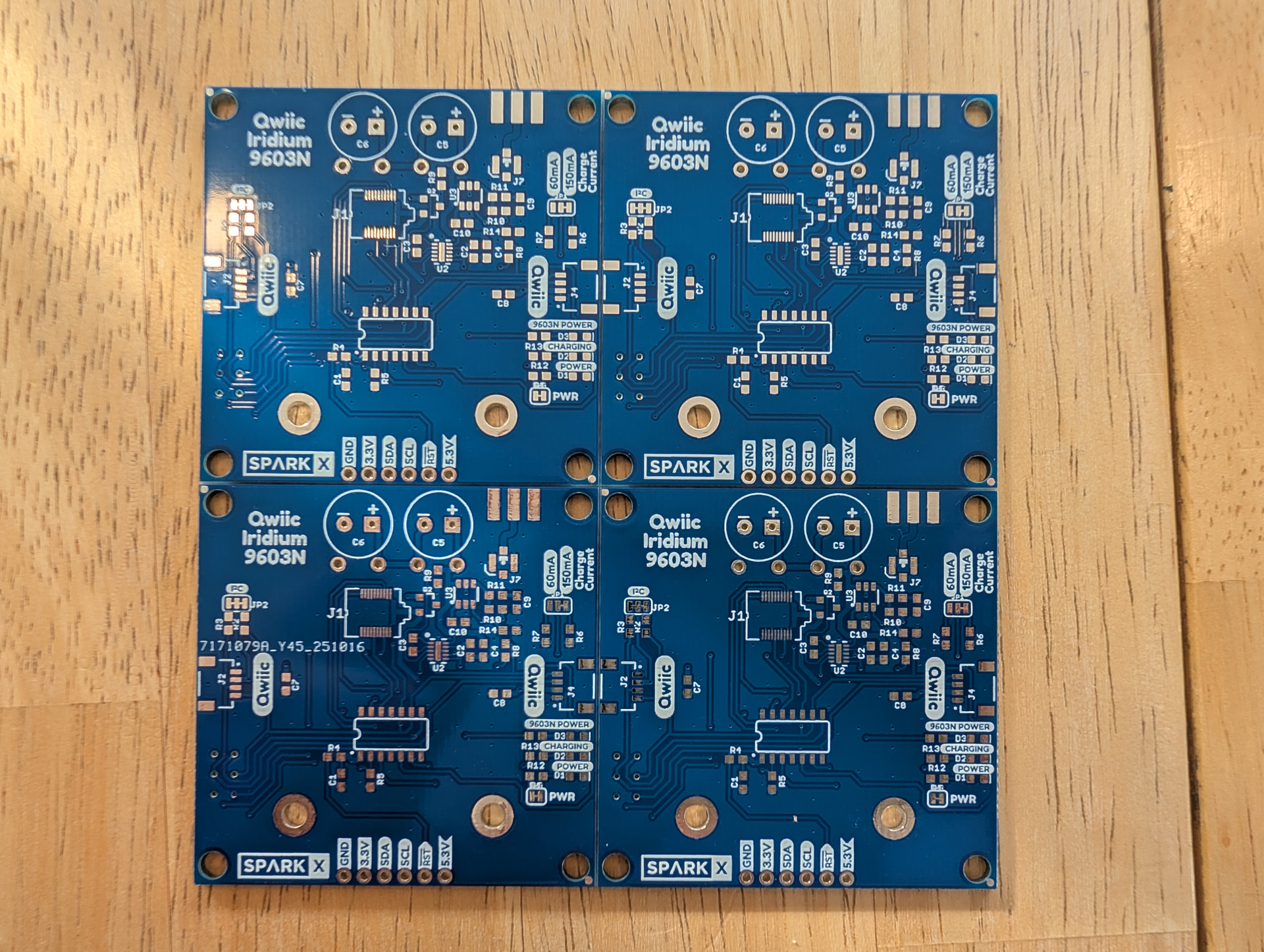

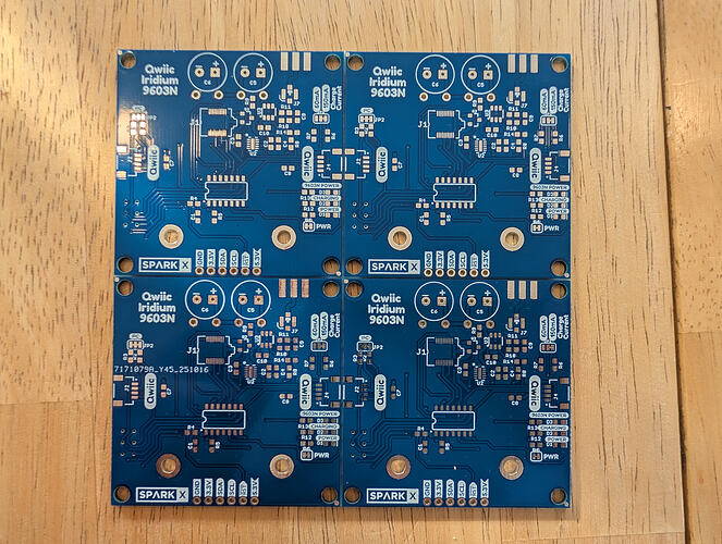

  1. Un-populated boards have been produced (see photo). Using the sparkX repo, these were exported as gerber files from Eagle (only change was clicking ratsnest), then sent to JLC for fab/stencil production. I have a Controleo3 and paste ready for fab. I am aware that J1 is a bear and will report my outcomes - advice is welcome.
  2. I have created an all-Digikey BOM from your “BOM of sorts”. This is my first BOM and I am unsure what the “gotchas” are, so if possible I would kindly request a BOM check (especially in the resistor section)… BOM can be found below (same file, in either Gdrive/digi link).

I’ve taken a quick look at your BOM and it seems OK.
The reflow standoffs we use are M2x0.4 x 6mm (DigiKey 732-7103-6-ND). They’re a lot easier to work with than the 2-56 press-in nuts.
Be careful when mounting the u.FL connector. If you put it on the wrong way round, it will have you scratching your head for days - trying to work out why you’re not getting an Iridium signal.
Good luck!

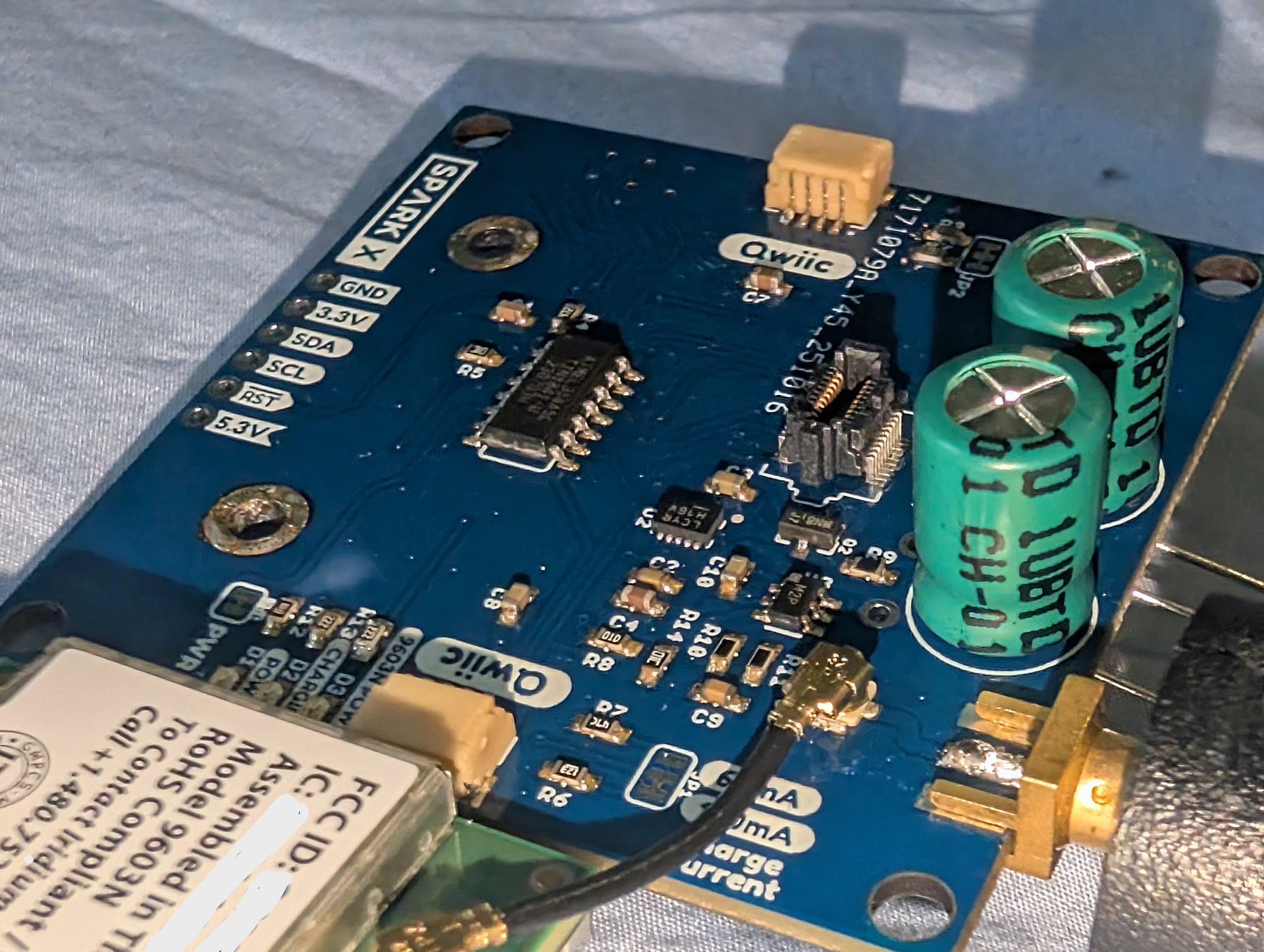

  • I am live on Rock7 and sending messages. Many thanks for your guidance, it gave me the confidence to get it done. See photo on Fig. 1.

Figure 1. Assembled PCB (minus antenna and standoffs).

Thanks for the update. Glad you got the board working. Well done on getting the Samtec connector soldered successfully!
