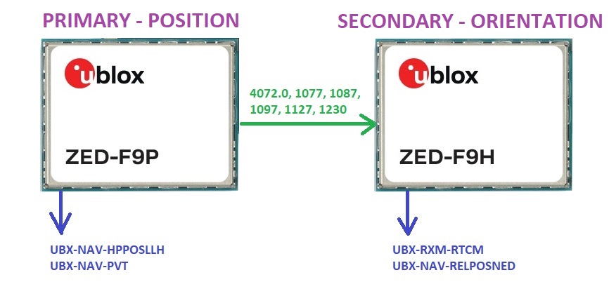

Here are some diagrams/illustrations I’ve previously posted to the uBlox forum.
For a first-order solution, one typically gets position from one unit, and orientation/direction from the second unit.

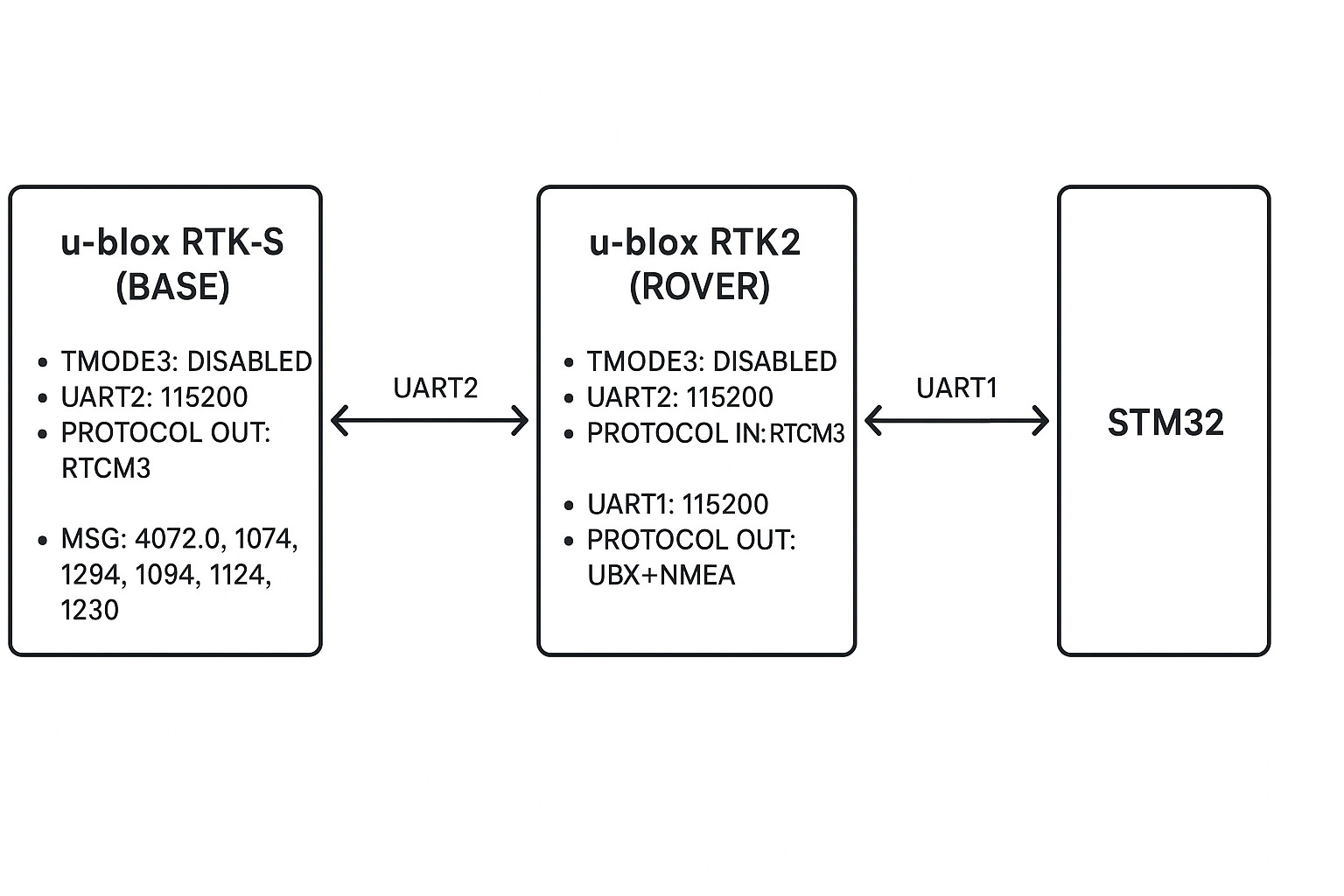

Perhaps diagram exactly what you have built and how you are configuring each unit.
here is an image representing what configurations i have done.
I have also enabled UBX_NAV_RELPOSNED MSG on UART1
Hi @manika_panchal ,
How are you configuring the two ZED GNSS modules? Over USB? Or over UART?
Please tell us what Protocol In and Protocol Out are on all ports.
Ok, and are you seeing and successfully parsing the UBX-NAV-RELPOSNED ?
Can you record and furnish the data stream you’re seeing on the STM32, or feed it thru to another serial port / uart for inspection.
Can you show the code, or portion of it, responsible for configuring the output of UBX-NAV-RELPOSNED ?
Make sure the Rover has UART2 PROTOCOL OUT:NONE

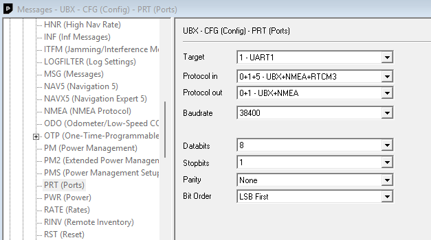

here is the image which confirms that im getting UBX messages but on USB ,i have enabled it for both USB and uart1 ,here is the image how i have configured it….now when im printing the received bytes on stm ..it shows only nmea no UBX
Please tell us what Protocol In and Protocol Out are on all ports - on both ZED-F9Ps.
Please post screenshots for UBX-CFG-PRT, showing UART1, UART2 and USB.
