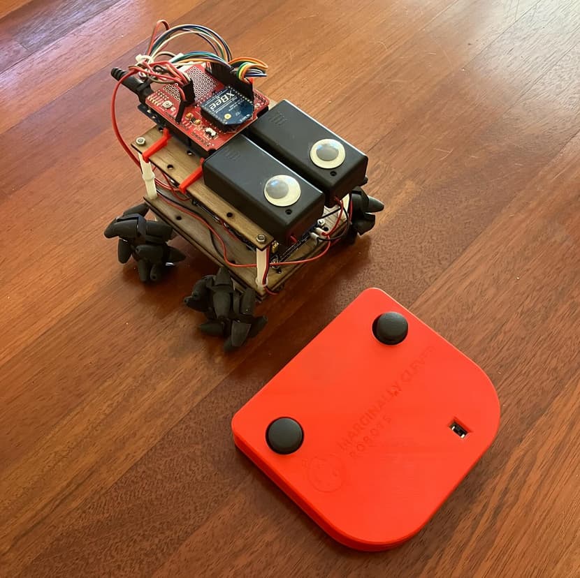

Hi!

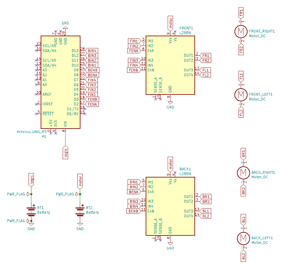

I’m looking to document an old robot I made, a mecanum-wheel car with 4 independent wheels.  I did a KiCAD schematic and the feedback was “make it even simpler, use Fritzing.”
So…. can someone help me with this, please?

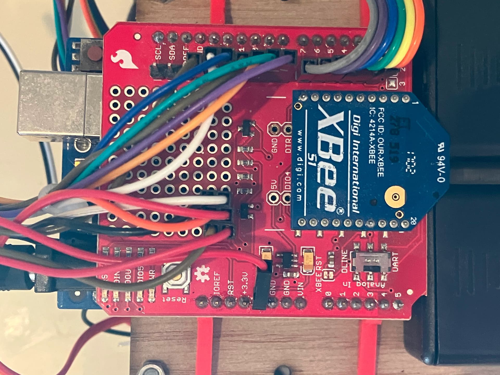

Here are my Kicad schematics and some photos of the machine. One illustration would be for the joystick and the other for the car.
