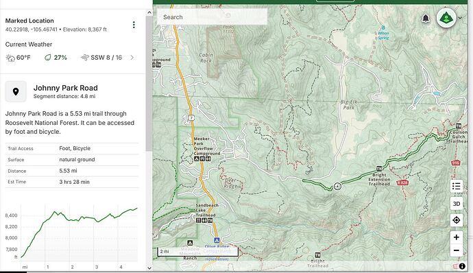

I use GaiaGPS, which among many similar offerings is easy to use and excellent for laying out hiking, biking or off-road vehicle routes in backcountry. It or others like it should work fine for your purposes.
Screenshot from GaiaGPS in a web browser. You might recognize the general area.
