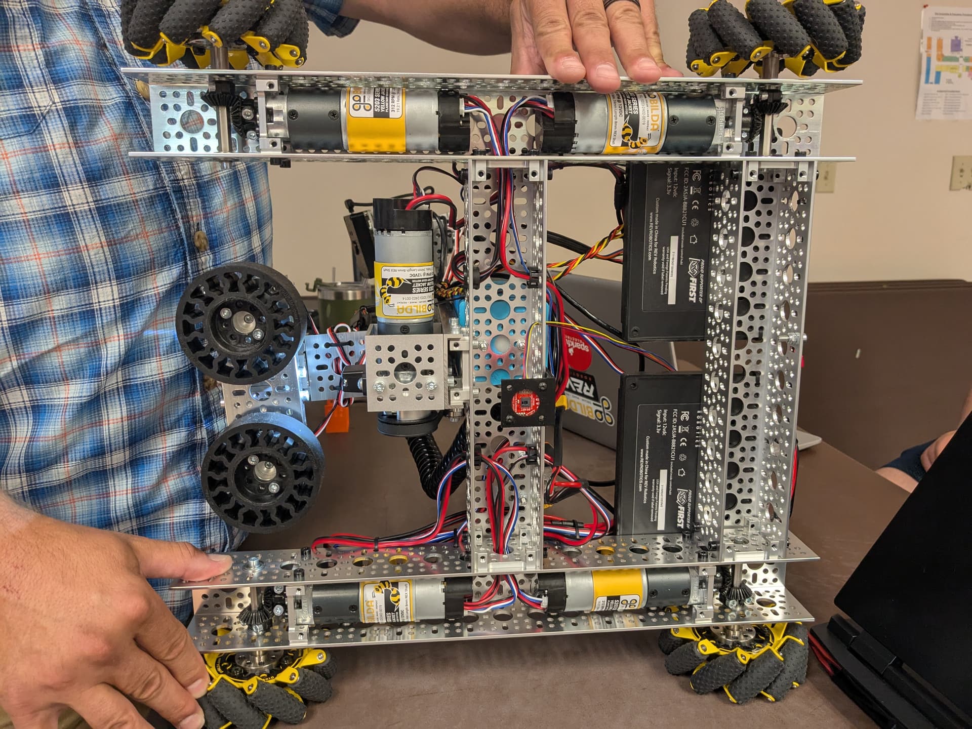

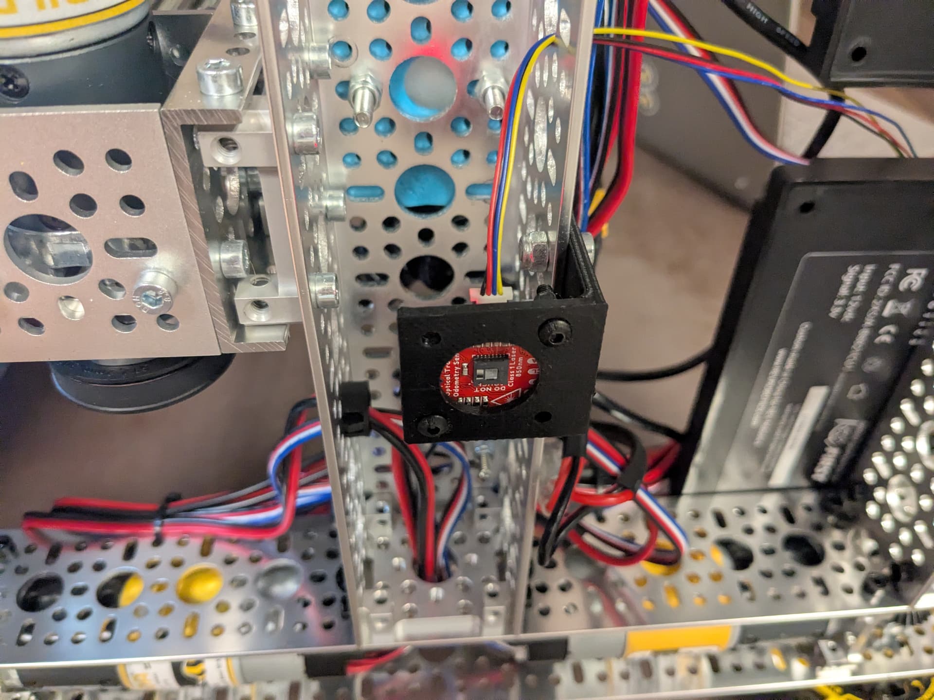

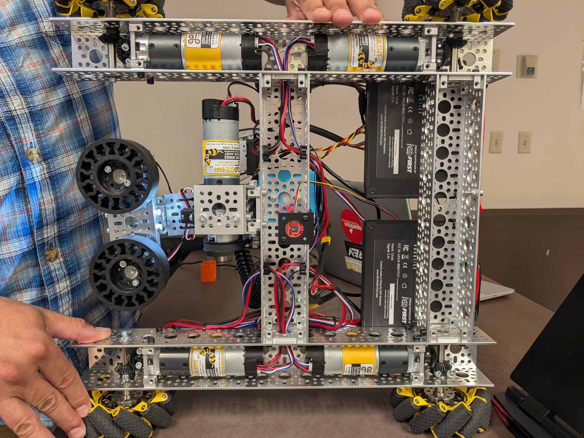

Thanks for your feedback! Here is how our SparkFun OTOS is aligned on the robot:
We also did some follow-up testing with the SparkFun OTOS, applying the offset angle and linear scalar adjustments you suggested. We found that an offset angle of: 0.4 degrees and a linear scalar of: 0.956 (with an angular scalar of: 0.9933) produced highly accurate results in both linear and strafing movement.
However, once the robot started moving diagonally, the SparkFun measurements quickly became inaccurate. In one test, the robot was given a sequence of predetermined coordinates to travel to, and by the time it reached the second position, the SparkFun readings were already significantly off.
At this point, would you recommend further troubleshooting, or should we consider moving toward getting a replacement?
Thanks for the images!
Hmm, hard for me to tell from the images if it’s mis-aligned at all. Your mount seems like it may be a bit flexible, so when your robot drives around, it’s possible that the sensor is wobbling. Could you please try the mount linked below? It was created by the folks that manage the FTC Onshape parts library, and to my knowledge, teams have had a good experience with it.

Only thing I’d recommend right now trying the mount I linked to ensure the sensor isn’t wobbling. Not sure if that would explain the error you’re seeing, but it’d probably be worth at least trying before getting a replacement.

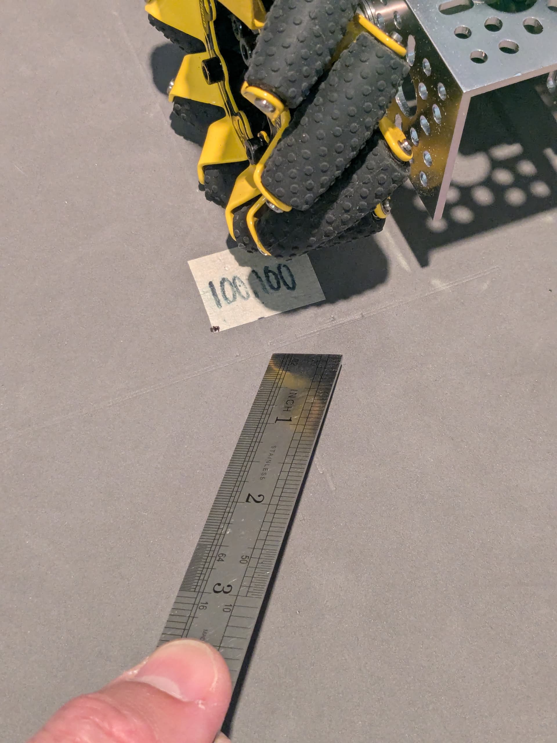

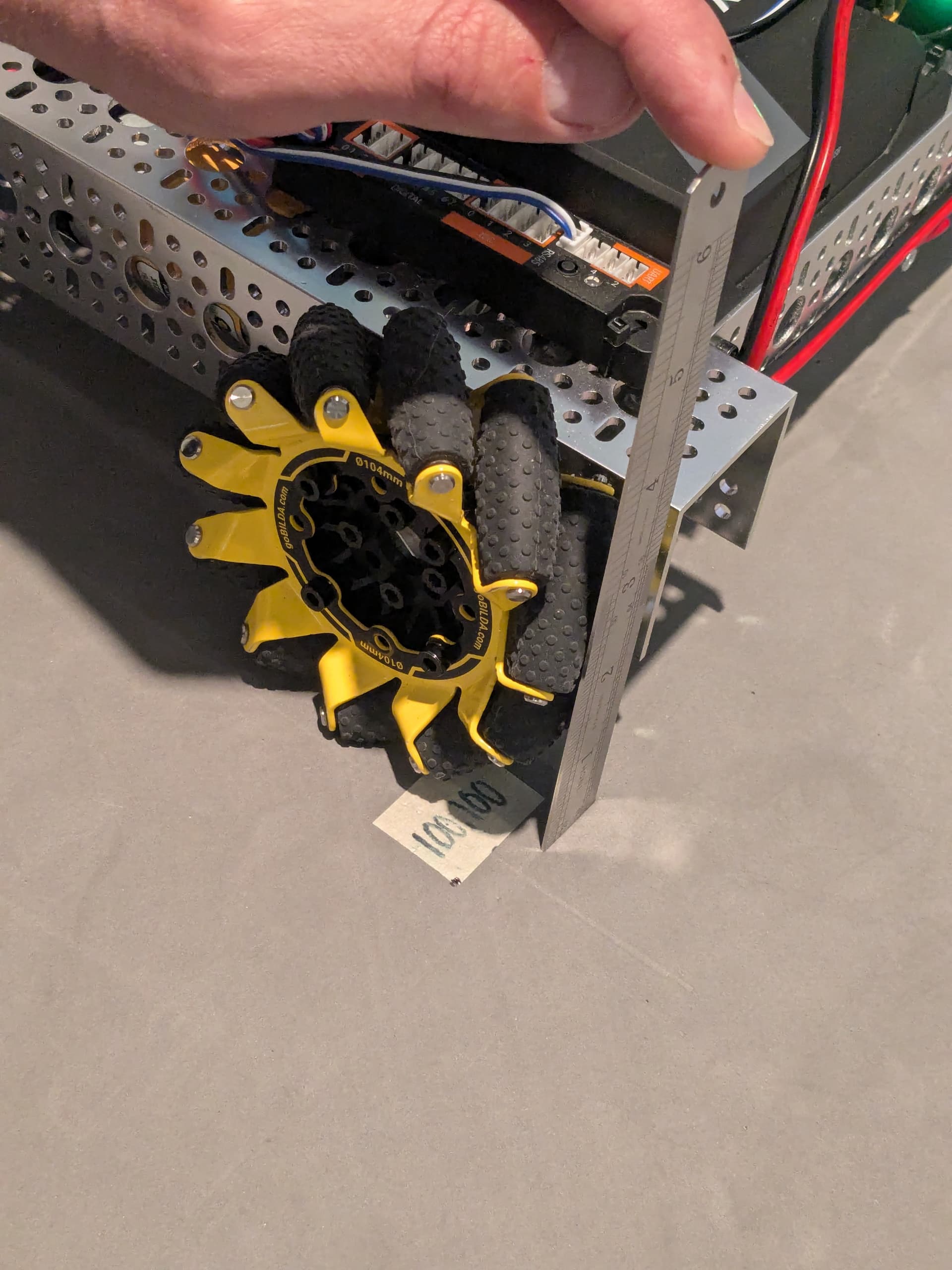

For our measurement method, we first mark the bottom-left wheel’s position by creating an imprint on the tile. We then measure the offset of the imprint from the tape corner (black dot), which had already been precisely measured.
Last session’s measurements came from measuring with a tape measure to 1/32 of an inch, then converting the measurement to a decimal. The excessive decimals (“10 millionths of an inch”) came from carrying too many decimals in our averages. This session’s measurements were taken precisely using a steel scale (a small metal ruler) with 1/10 inch graduations.
Here are some images showing the process:

Ah, good to know! Using a tape measure from the start location is good, just be careful about using too many decimal places, because it implies you have that many significant figures (also see accuracy vs precision, this was drilled into me in school :wink:).
I’ll also caution about using a ruler; if you’re measuring from the teeth of the field tiles, be aware that FTC field tiles are slightly shorter than 24".
