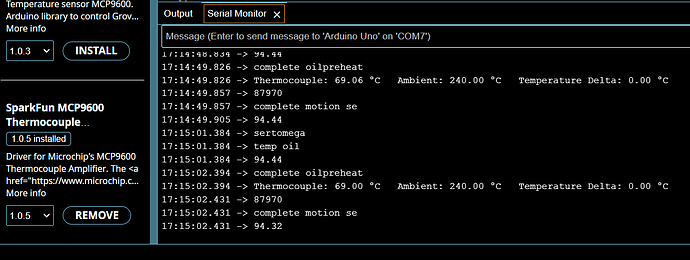

SparkFun Qwiic Thermocouple Amplifier - MCP9600 (Screw Terminals) AMBIENT READS 240.00 ON 2 CARDS
The ambient (cold ) junction reads 240.00 no matter what resolution settings are used, it will for one pass in about 50 passes com back with 24.?? which is what it should be. It is being read through an arduino Uno with 3.3v power

I pulled all the relevant code and made a new sketch the printout also has a few of the settings for the MCP9600. I reinstalled the library it is version 1.05 the print out looses the settings as seen in the filter coefficient it always goes to a 0 from what ever number it is set to. it happens to the cold or ambient junction but not at the same time, it goes from240.?? to 24 or 25 for 1 pass. I have a 500 delay it doesn’t show as often as it does at 100 delay. This is the key to this whole project when it works correctly it will be controlling two 1 mill. BTU burners in a home foundry.
I’m not sure why but reducing the clock timing below 9000 resolved the stability problems and the 240 dropped to 68. It doesn’t seem to be actually reading the t-couple correctly but that is a new problem.

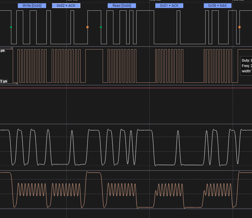

@Art_Bouvier : I spoke too soon. I can replicate your issue:
Previously I was testing with an ESP32. I dug out an old Arduino Uno R3, and I see:
09:38:28.723 -> Device will acknowledge!
09:38:28.723 -> Device ID is correct!
09:38:28.723 -> Setting Thermocouple Type!
09:38:28.770 -> Thermocouple Type set sucessfully!
09:38:28.770 -> Setting Filter coefficient to 6!
09:38:28.770 -> Filter Coefficient set sucessfully!
09:38:28.770 -> Thermocouple: 20.81 °C   Ambient: 240.38 °C   Temperature Delta: -0.50 °C   Filter Coefficient: 6
09:38:28.818 -> Thermocouple: 20.37 °C   Ambient: 240.38 °C   Temperature Delta: -1.56 °C   Filter Coefficient: 6
09:38:28.866 -> Thermocouple: 20.37 °C   Ambient: 240.38 °C   Temperature Delta: -1.56 °C   Filter Coefficient: 6
09:38:28.962 -> Thermocouple: 20.37 °C   Ambient: 240.38 °C   Temperature Delta: -1.56 °C   Filter Coefficient: 6
09:38:29.056 -> Thermocouple: 20.37 °C   Ambient: 240.38 °C   Temperature Delta: -1.56 °C   Filter Coefficient: 6
09:38:29.103 -> Thermocouple: 20.37 °C   Ambient: 240.38 °C   Temperature Delta: -1.56 °C   Filter Coefficient: 6
09:38:29.197 -> Thermocouple: 20.37 °C   Ambient: 240.38 °C   Temperature Delta: -1.56 °C   Filter Coefficient: 6
09:38:29.291 -> Thermocouple: 20.37 °C   Ambient: 240.38 °C   Temperature Delta: -1.56 °C   Filter Coefficient: 6
09:38:29.339 -> Thermocouple: 20.37 °C   Ambient: 240.38 °C   Temperature Delta: -1.56 °C   Filter Coefficient: 6
Looking at the I2C bus with a logic analyzer, I see:
Register 0x02 is the Cold Junction Temperature. 0x0158 is 344 * 0.0625 = 21.5C. So the chip is outputting correct values. But the I2C clock waveform is so terrible, the Uno is not reading the data correctly. This is with setClock(10000); . The clock speed should be 10kHz, but it is actually ~250kHz. It is too fast.
OK. This appears to be a known bug with the Arduino Uno. If you select 10000 Hz, you actually get 250000 Hz.
Please use setClock(100000); and all should be well.
