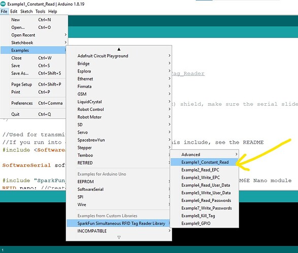

In order to cross-check, I connected the SparkFun Simultaneous RFID Reader with the Arduino.
While I connected with Arduino… all the connections were correct, Upload successfully.
I use the example code Provided by Sparkfun Arduino library ----> Example1_Constant Read.
Please see the attached images. I am providing use input, But it. not moving to the next Serial. print… as mentioned in Photo.

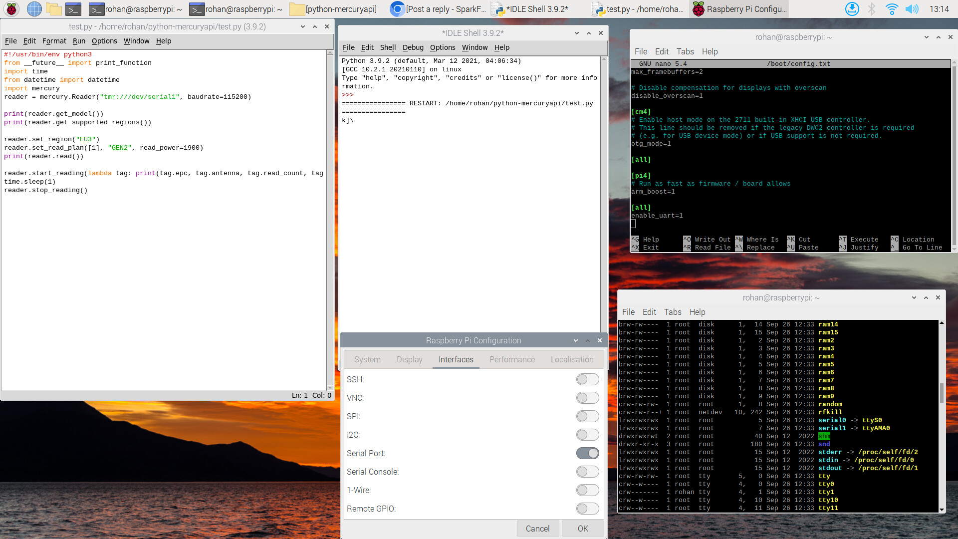

For the raspberryPI, double check in the instructions I included earlier (disable BT and disable console to serial). The device is called /dev/serial0 or /dev/serial1 (do ls /dev)
Yes the tag is stick to antenna as showed in above photos.
Yes you can see in this attached image. BT is disable and serial console is off.
Is there any other settings/ configs we can check ???

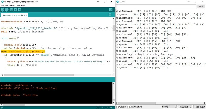

Also before calling “setupNano(38400)” include “nano.enableDebugging(Serial);” This will show the messages exchanged with the the Nano. Please share the output you get.

Also before calling “setupNano(38400)” include “nano.enable debugging (Serial);” This will show the messages exchanged with the Nano. Please share the output you get.
Please see the output of the code with changes…
Also, I have made the same connections as you mentioned and the tag is touched to antenna.
What I see is that it requests the hardware and firmware versions, it sets the speed to 38400, and requests the hardware and firmware versions again. That all works.
Now it tries to set the protocol to gen2 (93 00 05). THAT fails… and any call from there on fails. If you see the same outcome every time I think the firmware on Nano is having an issue.

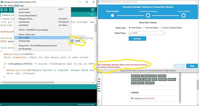

Yes, I try the URA from jadek/thingmagic…Not showing COM…
See attached picture…
Seems like firmware issue
What USB to serial interface are you using? That’s what the software is saying it can not find.

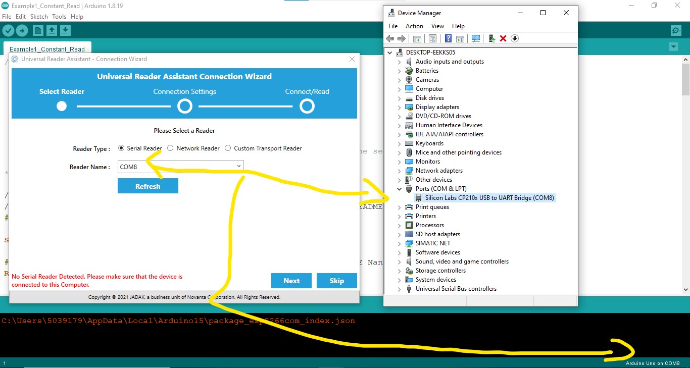

I am using one has IC “SILABS CP2102 DCL00X 1546+”…
https://www.silabs.com/interface/usb-br … ?tab=specs
Figure out what COM port your Si Labs CP2102 is on and put that in the Jadac software. Otherwise the software can’t communicate with the M6E.
As I mentioned in the Above picture…it’s COM8.
Not working on Jadac, but showing in Arduino IDE

Isn’t COM8 in the ArduinoIDE the Arduino Uno USB and not the Nano M6e directly connected with an FTDI?
No it just Nano connected via FTDI…and it’s COM8.
If I connect Arduion UNO without FTDI, it’s COM6.
I am lost a bit.
  • In your post from Wed Sep 27, 2023 7:13 pm it shows COM8 for the Arduino Uno in the IDE.
  • In your post from Thu Sep 28, 2023 5:18 pm you refer back that it is COM8 showing the IDE for the M6E, but that is for the Arduino Uno.
  • if you have an FTDI for the Nano, why don’t you use that with the Raspberry PI as that will give you /dev/ttyUSB0 and maybe works?
