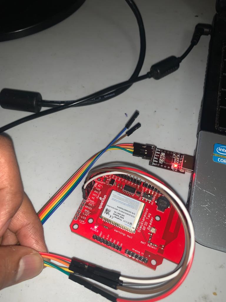

Do you have pictures of the M6E Nano connected to your PC ?
____I will attach in next post

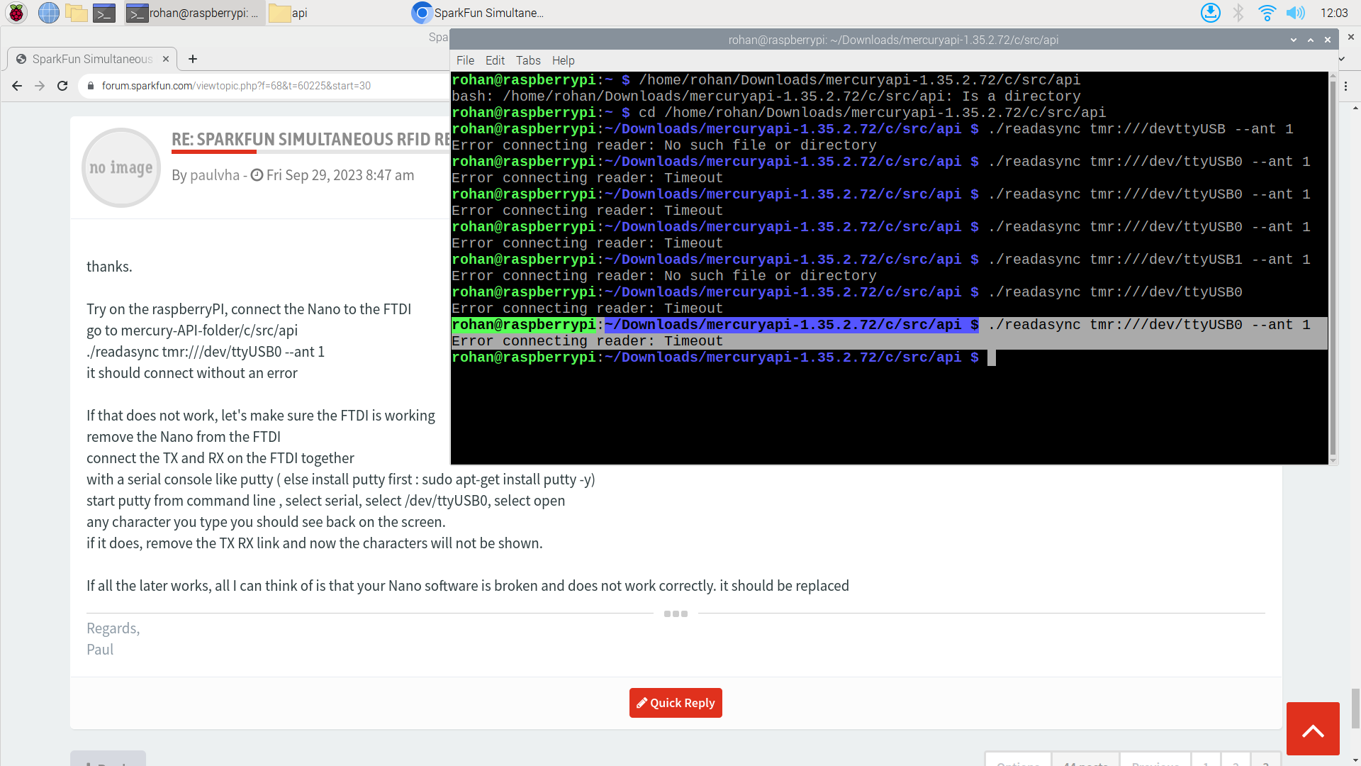

This is the picture of output…FTDI to Pi3…ttyUSB0…(Time our error)
try USB1,2,3…(File not found directory error)

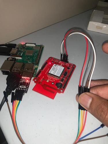

these are the pictures connected to Pi3 and my laptop using FTDI.
While Connected to the PC. it’s showing COM8 connected in the Control panel

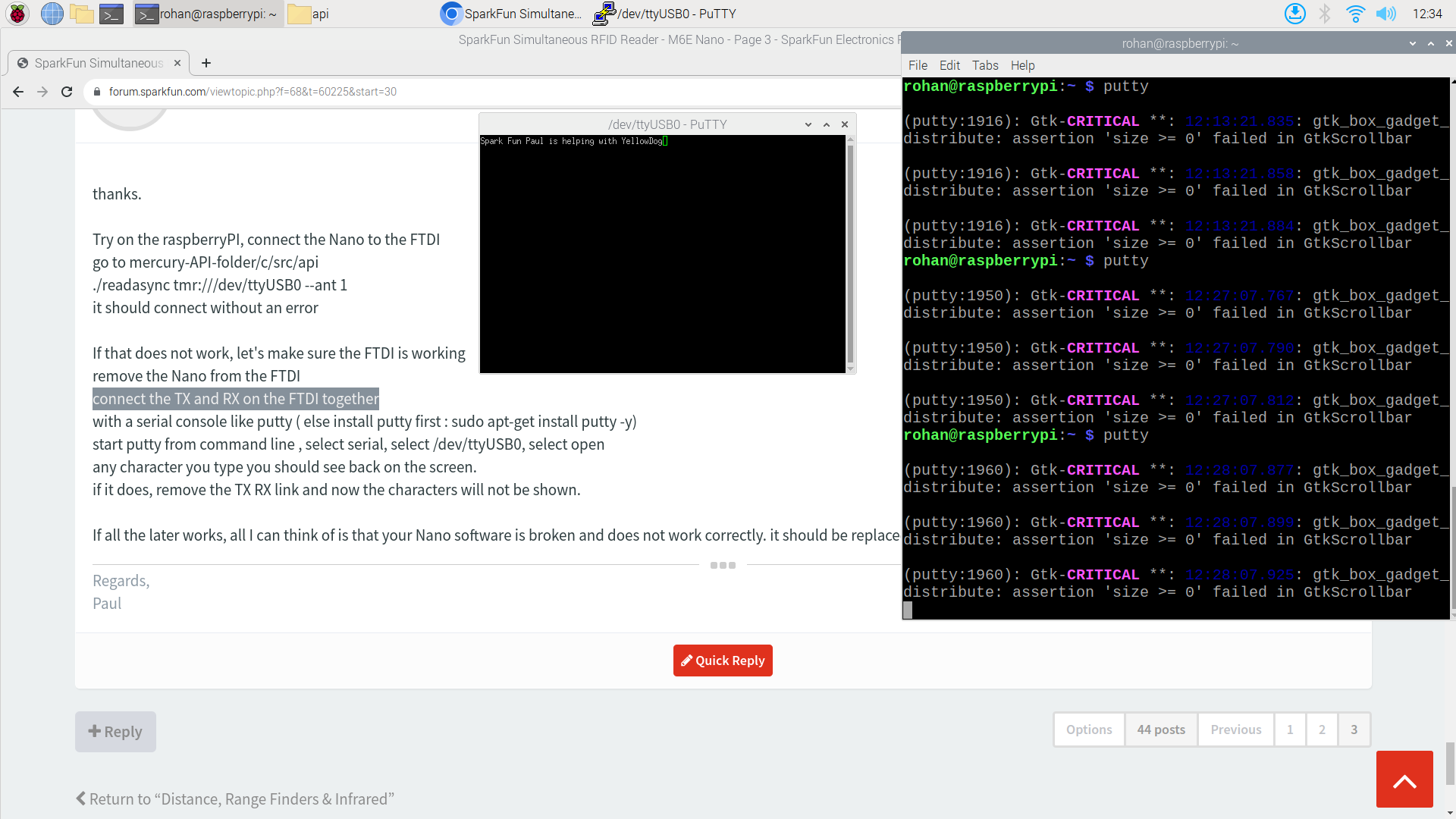

Try on the raspberryPI, connect the Nano to the FTDI
go to mercury-API-folder/c/src/api
./readasync tmr:///dev/ttyUSB0 --ant 1
it should connect without an error
If that does not work, let’s make sure the FTDI is working
remove the Nano from the FTDI
connect the TX and RX on the FTDI together
with a serial console like putty ( else install putty first : sudo apt-get install putty -y)
start putty from command line , select serial, select /dev/ttyUSB0, select open
any character you type you should see back on the screen.
if it does, remove the TX RX link and now the characters will not be shown.
If all the later works, all I can think of is that your Nano software is broken and does not work correctly. it should be replaced
yes as you mentioned I try raspberryPI, connect the Nano to the FTDI
./readasync tmr:///dev/ttyUSB0 --ant 1…and you can see error on the screenshot mentioned below.
Then I perform this
Working… You can see result
not typing and reflecting anything…see the attached picture

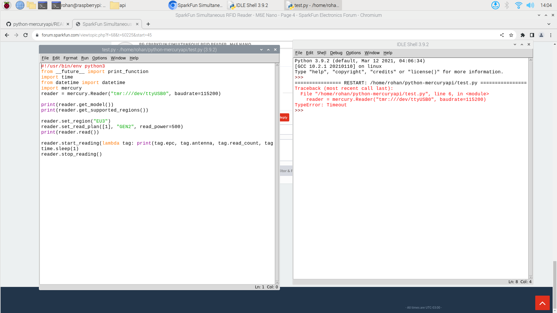

Now I have received the replacement and with arduino UNO…constant read program work if tag is just on top of that.
While try to running with raspberry pi 3, I am getting Time out error…
please check the attached picture.

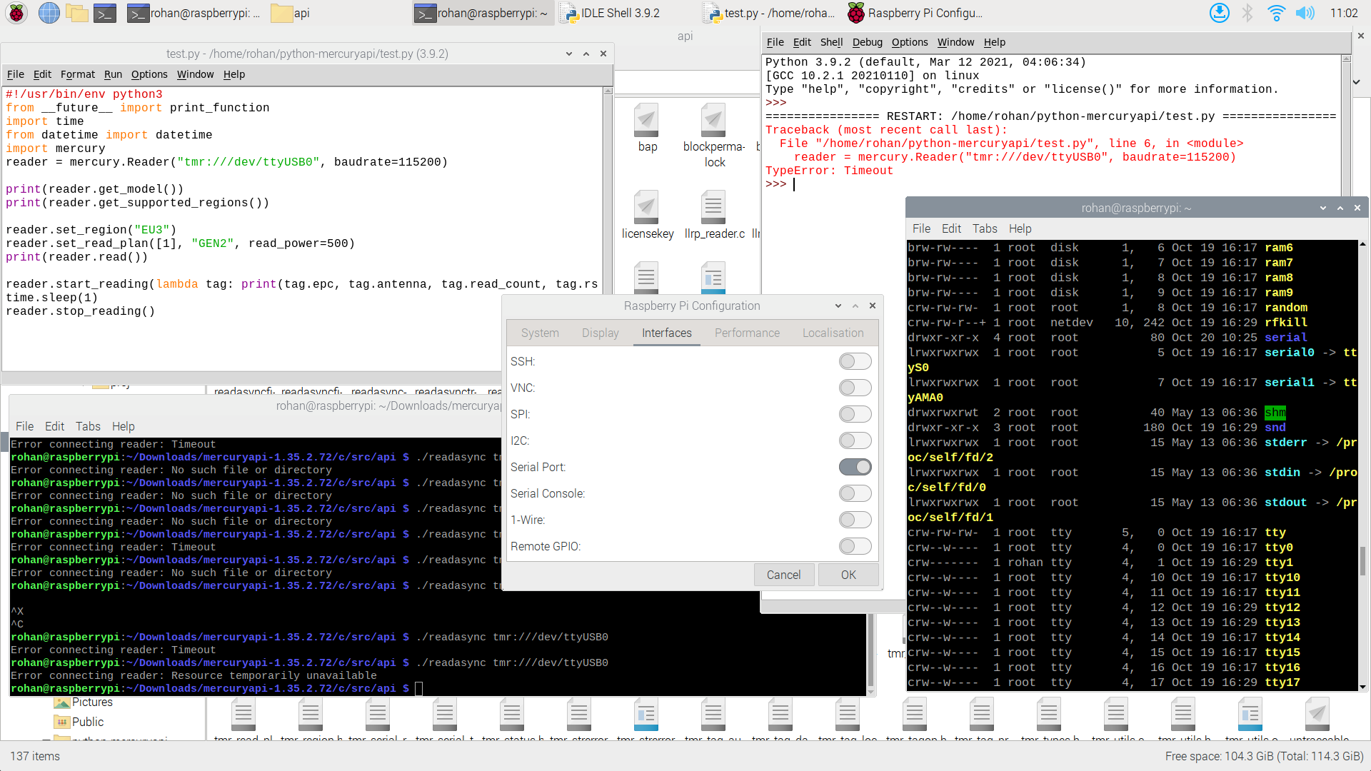

**- Yes i try ans see the result in attached picture**
paulvha
October 20, 2023, 4:34pm
52
Please : Don’t try to put many pictures in one picture… it is impossible to read.

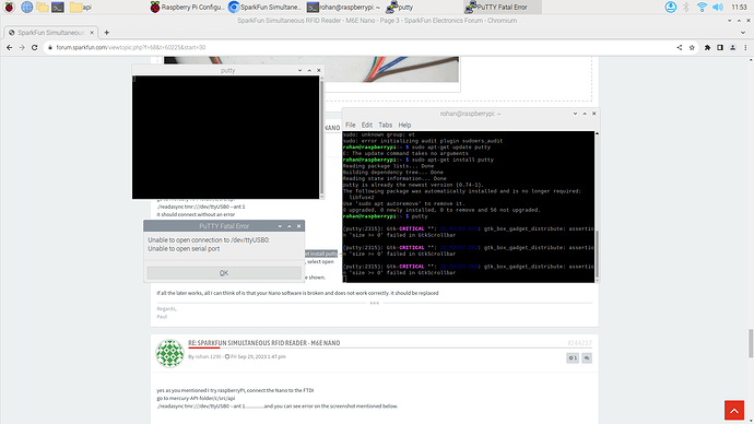

Putty seems to indicate it can not open /dev/ttyUSB0. Can you confirm why would that be?
Yes No many thigns in one picture
I restart thr pi3 now it’s good, putty system is working.
but when try to read I get the same error of time out

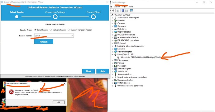

I try in Windows, Universal Reader…It’s showing the same…No serial reader detected…
See the attached picture.
No other device is connected…Just my USB mouse and Headset.
Do you want additional information? I just follow the steps mentioned in the Hookup guide.
Can you guys please confirm why this is bothering…

What about Raspberry Pi 3, I am still getting Time out error…
