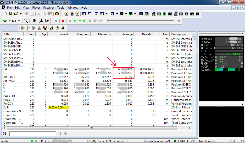

My ZED-F9P receiver is a dual-frequency receiver L1/L2, so at my measurement location the sky should not be obscured by trees and buildings and should be at least 5 m from any terrain obstacles.
I placed the antenna with a metal round base connected to the ZED-F9P receiver on a round, level base on a tripod about 1.5m above the ground. The base’s task is to shield the antenna from below. Therefore, it should not be too large. The diameter of the base is a few centimeters larger than the diameter of the antenna. If it is too large, it will cause additional signal reflections and will be very susceptible to even small gusts of wind.
  1. The ZED-F9P receiver with 1.51 firmware is connected via USB to the laptop. The laptop has an Internet connection.
  2. I am launching the u-center application 25.03.
  3. I set the baud rate in the menu
    Receiver → Baudrate → 115’200
  4. I connect the application to the module in the menu
    Receiver → Connection → COMx
  5. I provide a window to display Fix mode by checking the selection in the menu
    View → Docking Windows → Data
    In the Data window, the Fix Mode field should display 2D.

    If the connection to receive data from the base station was successful, the status at the bottom of the window will be NTRIP client: ip_address:port. The Fix mode field value in the Data window will change from 2D to 2D/DGNSS or 2D/DGNSS/Float. The base reference station is less than 10 km from the measurement site.
  7. In the menu I select View → Deviation Map to display a window with the measurement position.
  8. I click the button with the letter A at the bottom of the Deviation Map window meaning Set centre to average position.
  9. I wait until the Fix mode field in the Data window changes to 2D/DGNSS/Fixed. This may take a few minutes.
  10. When Fix mode is set to 2D/DGNSS/Fixed I click the Empty database button at the top to start collecting data from the beginning.
  11. I click the Properties button of the Deviation Map window located at the bottom, on the left side of this window. The Deviation Map Properties window will appear, in which the first field should be set to Average, and the Max. Deviation field should be set to 0.04. This is used to observe how large the spread of measurements is. If the measurements go outside the 2 cm circle, then we probably have low measurement quality. I click OK.
  12. I save the measurement results by selecting Player → Record in the menu. A window with a suggested file name will appear. I click save and confirm adding the receiver configuration by clicking Yes. Now the measurement results are saved to a file.
  13. I wait about 2 minutes, during which Fix mode should be 2D/DGNSS/Fixed all the time.
  14. I finish saving the results by selecting Player → Eject in the menu. I disconnect the NTRIP service by selecting Receiver → NTRIP Client… from the menu and disconnect the U-Center application from the receiver Receiver → Connection → Disconnect
  15. I open the Player → Scan measurement file, select the file and click Open. I play the file to the end Player → Play → Maximum throughput and in the lower right corner of the Deviation Map window I read two numbers defining the average position. These are the 3D coordinates without height. Note: Not to be confused with the Longitude and Latitude fields of the Data window, which are usually located in the upper right corner.
  16. I disconnect the measurement file Player → Eject

I have reread all the six variants and I understood that Your intention is to have confirmation on the correct procedure;so I answer positively,but it would be lawful if you had a setup with a theodolite, which for simplicity of calculations consider only the plane coordinates. Using a gnss receiver, even the cheapest one, the situation is as seen by the Others…and, I think, that as for Cassini-Soldner also the Flat projection is deprecated for gnss.
Thank you for your reply as it is the first on the topic.
From what I understood you wrote that you do not measure position the same way as I do. You further explained why.
The main difference is that you don’t average the result from the point cloud like I do, you just read the measurement of one last point. I think it’s called instance measurement. This allows you to instantly read the result in the u-center app from the data window, which is usually located on the upper right side. You also do not need to clear the database or restart the receiver. You simply move to a new location and read the position. The same principle is probably used in all dynamic models where the antenna moves faster than the measurement frequency and the measurements with movement are called kinematic measurements.
I know the table you presented. Your comment that the selection of the dynamic model has no effect on the determination of the point position when the antenna is stationary or moving slowly indicates that the selection of the dynamic model is used to select an interpolation algorithm, i.e. one that calculates the approximate position in the case of rapid antenna movement and no data from satellites or a reference base station. This is very important when, for example, the car is driving in urban areas, so-called street canyons, because the receiver can constantly show the position, even if it is an approximate position. It is similar with agricultural machinery, where sometimes it is only important to maintain the direction of travel.
In a stationary measurement, I try to collect a point cloud with fix status over a period of several minutes and average it to determine the position. This allows me to achieve better accuracy by about 1 cm. Therefore it is important to clean the u-center database before measuring the next location. I do this in one of the steps. Can I use warm start instead?
I determine the horizontal position in the 3D coordinate system in which the coordinates of the base reference station were given. It is important to distinguish that I do not determine the position in the 2D coordinate system, only a 2D Fix is ​​determined, i.e. fix only for lon and lat. Then I convert lon and lat using the Proj program to the 2D coordinate system, i.e. the map system.
So I take measurements on different days to make sure I haven’t made a mistake or the satellite system works properly.
The ANN-MB-00-00 antenna with variations of the central phase point less than 0.01m is sufficient for me. The ZED-F9P RTK accuracy of 0.01m+1ppm, the distance from the base station less than 10km, gives the receiver accuracy of 0.01m+0.01m. I don’t remember now whether it is sufficient to sum it up. If so, it gives a theoretical accuracy for the antenna and receiver of 0.03m. However, averaging the point cloud allows for slightly better accuracy.
I sometimes perform static measurements using the rtklib demo package with a time of 50 minutes. It seems that the measurement time of 24 hours is exaggerated, because a few years ago I read a study that when measuring for several hours, the results obtained were not much different from 24 hours. The technology has advanced. It is important that the sky is not obscured and the antenna is at least 1 m above the ground.

  1. In the menu I select
    View → Statistics View
    to display a table with the average measurement position.
