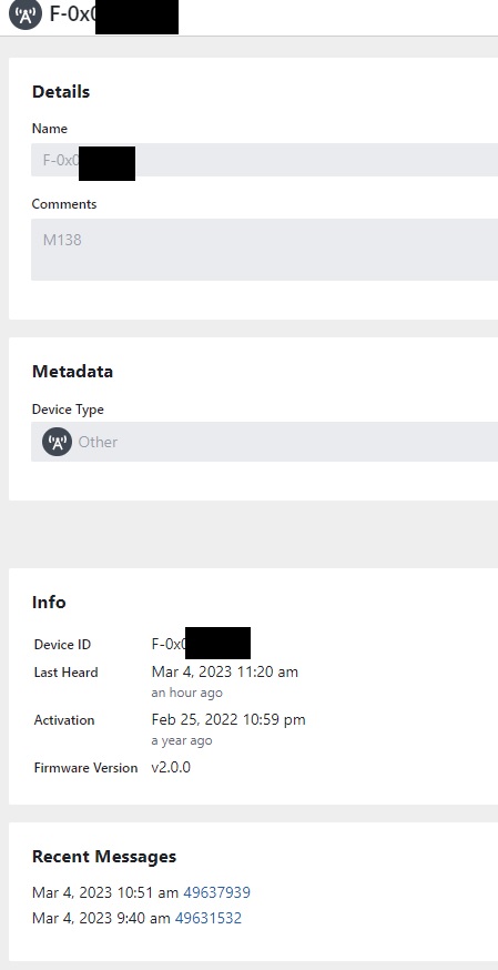

Got the TD SENT notification - for the Hello World uplink message:
Humm. Interesting. I think “last heard” might match the time the TD SENT notification came through? It’s ~30mins later than when the uplink message was transmitted:
so somewhat good news, I was just checking count read and finally the message I sent the other day showed up:

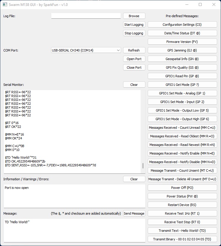

https://github.com/sparkfun/SparkFun_Sw … 4331264386
For Windows, you need the SwarmM138GUI.win.zip. It’s double-zipped. You’ll need to unzip it twice to get to the .exe. It should behave exactly the same as the original version. The only significant difference is that the port Refresh button has been deleted. Clicking in the port list box automatically refreshes the ports.
Let me know if it works OK for you. Thanks!
Ah, sorry. You won’t be able to download those files… They’re protected. I’ve created a full release - which you will be able to download. Please give the win.zip a try - if you can spare the time. Thanks!
https://github.com/sparkfun/SparkFun_Sw … I/releases
Hi Paul
got it, it says 2.0.1 in the title bar, I queued up another message to send to the modem and ran the notify enable, in the swarm web age it ‘Sent to Ground Station (EST)’ but not the satellite yet

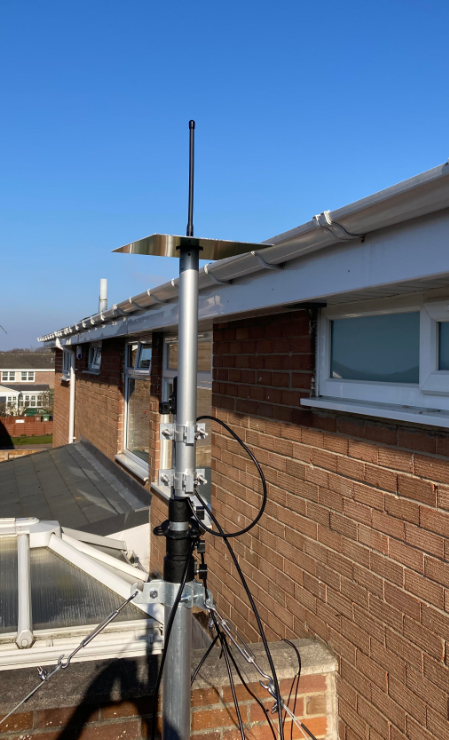

Hello @juliadest,
For these tests, I was using the Swarm antenna with a square aluminium ground plane (8" x 8" - the same size as the SparkFun PCB ground plane). It was mounted on a telescopic pole, and extended just above the roof line of my house. It was connected to the modem via 15m of RG58 cable.
I have attached some photos.
Working down from the top:

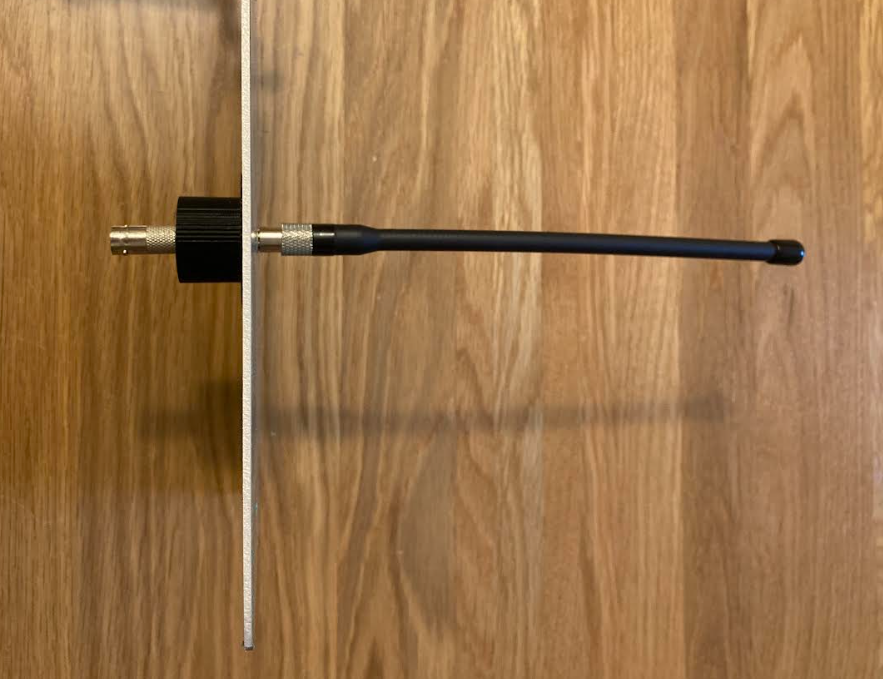

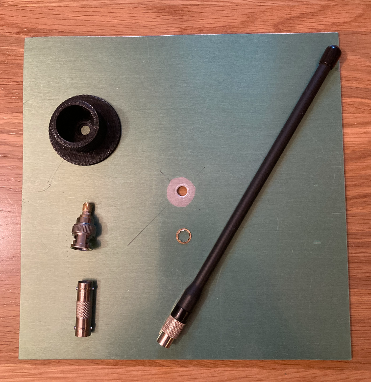

Swarm antenna
SMA (1/4") shakeproof washer
Aluminium ground plane
3D-printed adapter for the telescopic pole (black plastic)
BNC-SMA adapter
BNC-BNC adapter
The BNC cable runs through the top part of the pole and connects through the BNC-BNC and BNC-SMA adapters.
I use another BNC-SMA adapter to connect the BNC cable to the modem breakout.
I hope these help!
