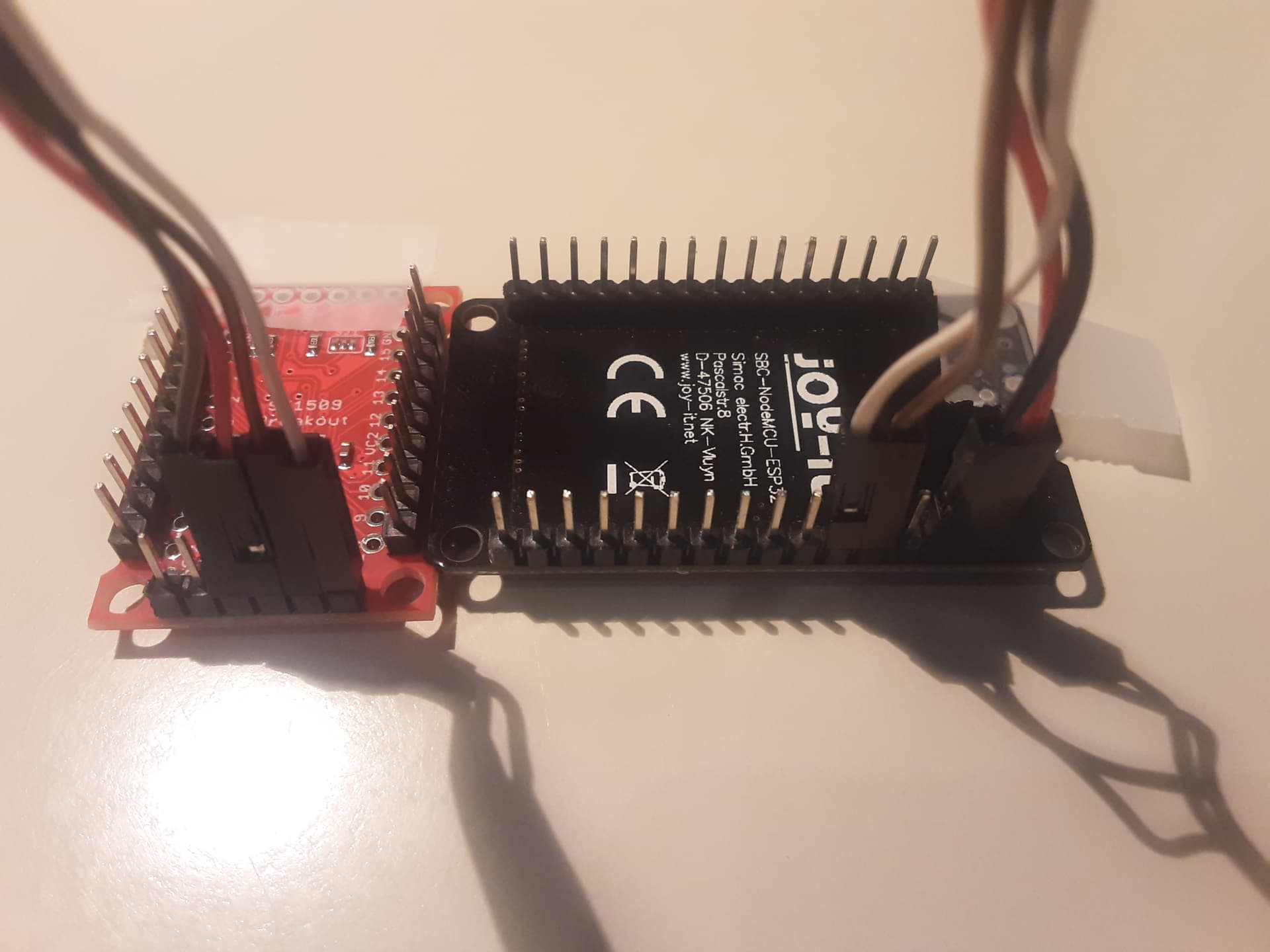

Hello
Error msg = Failed to communicate. Check wiring and address of SX1509.
Thanks in advance

              Can you share a photo of your setup/wiring?
              I use 4 wires
Red = 3V3
Gnd = Black
White = SCL
Brown = SDA
              You need to tell  SX-1509 driver that it needs to use the I2CSX instead of the default Wire.

              try this:
change TwoWire I2CSX = TwoWire(0);
to TwoWire I2CSX = TwoWire(1);
What happens if you use to the default  Wire  & connection points?
P.s. be aware the GPIO2 has a special meaning during boot: must be left floating or LOW to enter flashing mode
              Same error

              The Wire is using i2C-number(0) and is always defined. What happens if you try Wire.begin(2,4)?
Did using i2C-number (1) made a difference ?
Still concerned about using GPIO2, with the i2C there should always a pull-up resistor on the SDA and SCL line.
              Same error with Wire.begin(2,4)
SX1509 has pull-up resistors for SDA & SCL
I don’t understand “Did using i2C-number (1) made a difference ?”
              From earlier post:
But if it does not work with Wire.begin(2,4).. I don’t expect that will make a difference.
Somehow the wire does not work on this way/

              no I don’t have an Sx1509.. I don’t expect that to be the issue here. something to do with  Wire. Something basic.
How about trying GPIO5 for SDA : Wire.begin(5,4) ? or another pin for SDA or SCL
              You have right : Wire.begin(13,14) is OK
