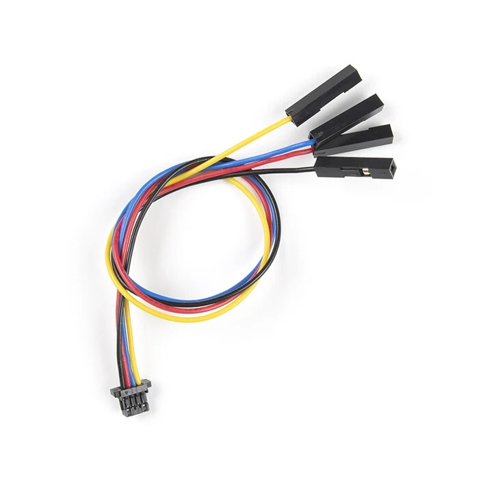

I’m using a 200mm Qwiic cable (show as the below picture) to connect the sensor to my Raspberry Pi. The setup only uses the sensor’s internal pull-up resistors.
Based on your suggestion, I’ll try using a shorter cable to see if it resolves the issue. Besides the cable length, are there any other common factors in a setup like mine that could cause these spikes?

I’ve performed several tests based on the i2c bit error hypothesis, but the spikes still persist:
  • Cable: change to a much shorter Qwiic cable (50mm).
  • Pull-ups: increase the pull-up strength from 2.2k ohm to 990 ohm.
  • I2C Speed: test slower speeds: 100 kHz, 50 kHz, and 10kHz.
All of these steps failed to eliminate the single, large data spikes.
My current setup uses the Raspberry Pi’s 3.3V rail to power the sensor, with the Pi itself running on the official power supply. Is it possible the noise on the Raspberry Pi’s 3.3V line is the root cause? Would you recommend adding an external decoupling capacitor near the IMU, or should I switch to an entirely separate power supply for it?
