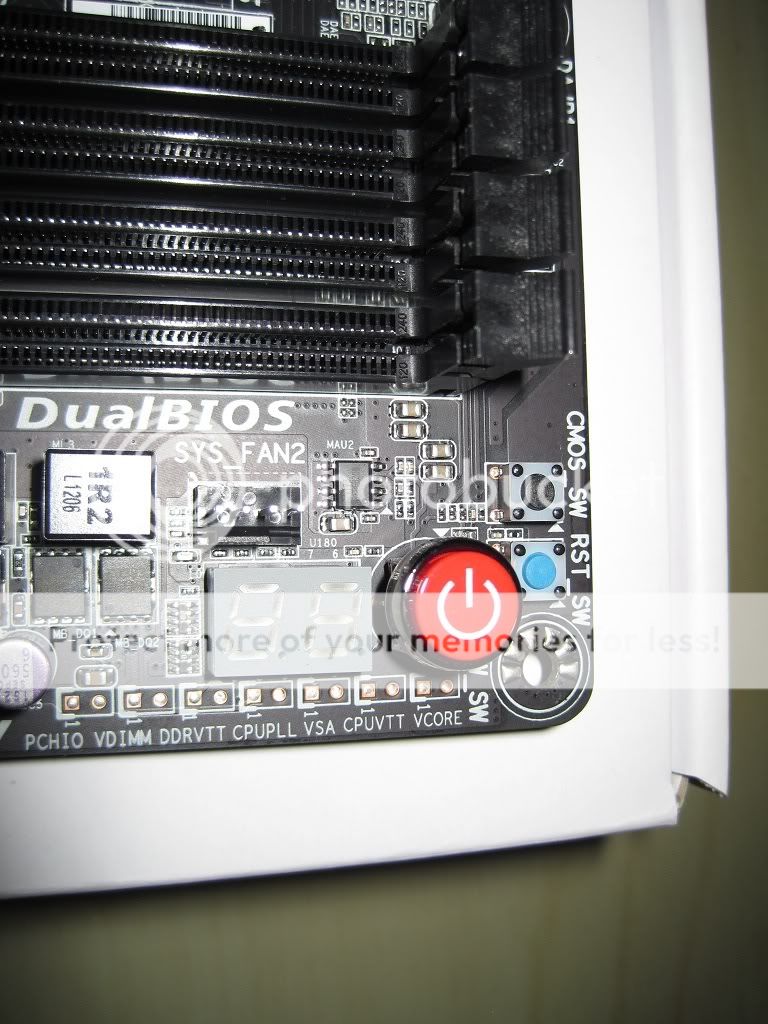

I’d like a voltage display. I see a ton of them on sites like this and ebay like with 7-segment displays. LCd, 7 segment, I’m okay with any of it.
I would like to attach them to my Z87X-UD3H’s voltage read points, just solder them on:
http://i1232.photobucket.com/albums/ff3 … G_0479.jpg
I see lots of displays for sale, it looks like I could just buy one and it’s all good to go, but there’s a few problems I have:
  1. I need one that has x.xx voltage. All the ones I find only read to xx.x voltage.
  2. I need to use external power, it can’t draw from what it’s reading as that’d be really screwy since those volts are going to the CPU and VRIN.
  3. Voltage range of 1v to 3v. If you want me to be more specific, than .1v-1v to 1.7v (the lower min the better but i could live with a min of 1.3) and another at 1.8v to 2.6v.
  4. Blue text (red is acceptable). 7-segment or LCD Blue negative (or red) i believe is what I have in mind.
That’s all. I’ve considered just buying a DMM and just ripping it apart but… yea, hopefully I can avoid that.
Specifically, i’d like to solder it to my CPU Vcore and CPU VRIN points. I know I’ve talked about reading software/mobo readings in a similiar mod, but this needs to be hardware level and thus I can’t use an arduino for this (or I could, but either way the data needs to come from these voltage read points. only other choice would be reading from the back of the phases but that’s basically same thing…).
Thanks. I’m hoping this is an easy answer and just a simple “yea buy this off ebay, this guy just isn’t listing all the info but we know this is the right thing” or "buy X parts and put it together’.

What is the Voltage range you wish to display? You say x.xxV, does that mean 9.99V max?
Many of the panel meters can be setup to display this Voltage range.
Sorry. Voltage range would be 1v to 3v. I can be more specific if necessary. I plan to just mount them inside my pc (which has a window) right next to the coltage read points on the mobo. Id use the psu’s 5v or 12v but I can use batteries too.

Yes, this is exactly what I am finding only, and what I referenced. Like I say in the title and OP, I need one with .01 resolution, not .1 (ie x.xx instead of xx.x). That voltmeter also has a useless range. I need ~1-2v at least (ideally 0-3v but I could buy 2 different ones or I can sacrifice and just get one with 1.4-1.6v and one at 2-3v).
It also needs to use external power, which I’m not sure that one can do. The red text on that 7-seg is fine, i’d prefer blue, there are blue ones like the one you linked.
This is specically for CPU Vcore and CPU Vrin on haswell, so I’m watching my cpu’s true voltage at ~1.4-1.6v range (high overclock, extremely dangerous burn-out voltages) and VRIN ~2.5).

Just going to get a quick confirm here that this is what I’m looking for:
.01 resolution (that is, goes to the X.XX spot, ie 1.52v, 1.51v).
0-2.6v range at least
Runs off it’s own power instead of source’s power
Blue Text
Refresh rate: about 300mS / times;
Measure Range: DC 0-3.300V
Display Color: Blue
Input Polarity: DC voltage;
Overload: 4 times range;
Input impedance: 100Kohm;
Display: 4 digit 0.36" LED Tube
Accuracy: 0.002V
Power Supply: DC7-28V;
Operating temperature: -40 ℃ -85 ℃
Dimensions: 40.5mm x 24mm x 17.5mm
Cutting Size: 37.5mm x 21mm
Anti-reverse protection, Overrange display 0
So AC range, check. Blue, check. Resolution, check. I’m not sure on the dedicated power supply thing though. I see power supply DC7-28v, so I hope I can just hook these up to the 12v rails on my computer’s PSU? They only need to be on when PC is on, as it’s measuring CPU voltage and CPU VRIN voltage.

I assume the wiring is Measure → (+) of measured thing, Voltage line to power, and then for black… you splice it into 2 lines and one goes to power,one goes to (-) of what you measure. And if you were to use the power of what you measure, you would juts go black/measure to (-)/(+) of what you were measuring and leave red off.

3% of 1.5v = .0045. Plus one digit so… .0046 accuracy? So that means it’s slightly worse than the previously mentioned display, but 10x the range?

I got a question about wiring - say I did want to use the source for power, would I attach green and red wires (measure/(+)) or just leave measure hanging?

Accuracy is typically specified as a percentage of full range so 0.3% of 33V is 0.11V, + 1 digit at that range, let’s say it’s on a .01 V resolution, would be 0.12V accuracy.
Oh wow, I wouldn’t have figured that. So basically I want to get the voltmeter with the lowest maximum range. Which means either tha 30v one I just picked, or the 3.3v one earlier that I had to clear out all the gunk from.
I messaged the sellers and they said they couldnt sell it separate, ill email them again saying my purchase is contingent on it. Or maybe I’ll see if I can findvit sold separately elsewhere.
Realistically, 0.12V accuracy for those meters is pretty good. I wouldn’t expect anything better than that.
yea but i can’t have it say 1.5v when its really 1.6v. saying 1.55v when it’s 1.6 isn’t really good either. Acceptable woul be like 1.58v when it’s 1.6v maybe.
So I’ll have to find one with either high accuracy or ~3v max.
